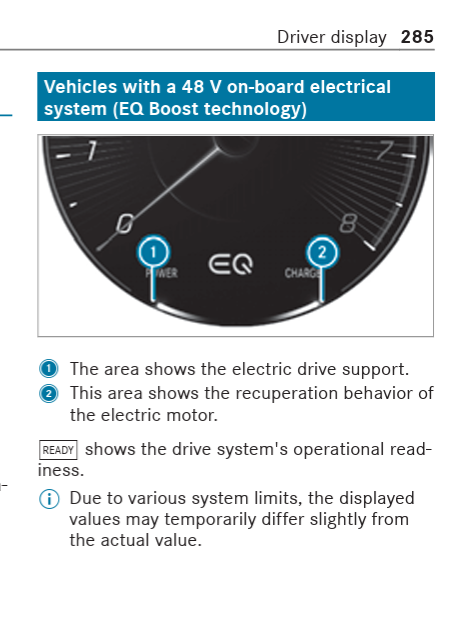

This is a repeat thread, but I now have a picture of what I'm talking about. I just got a 2022 W223 S580. I can’t figure out what the eq (miles and time) mean at the bottom of the trip computer. Also the eq charge at the bottom of the tachometer.

Don't quote on me, but I'm guessing that's what the mild hybrid (EQ) was able to assist in moving the vehicle?
Total of 2 miles moved w/ 23min of use? No?

Pretty much yes. I don't think this is explained in the owner's manual, but trip computers in hybrid cars typically break out the mileage and time that the car was driving on electric power. Given that mild hybrid can't drive the car in pure electric mode, it shows for how many miles and minutes/hours the electric motor was assisting the combustion engine. So for 2 miles out of 43 miles the electric motor was assisting and for the remaining miles it was running purely on combustion and that electric assistance was provided over 23 minutes. Looks like stop&go traffic mostly, or sitting at a standstill with engine off and not moving, but the 48V system running the AC etc.
The EQ Charge indicator at the bottom of the tach shows in more detail when energy is being recuperated into the 48V battery and when it's being discharged for assistance.
