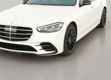

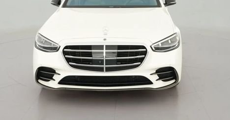

Can anyone tell if this looks like DIGITAL LIGHT headlights? I have a W222 with ILS+ and it’s a big deal for me. Thanks!

What model year is the car? Digital lights showed up on the 2025s - maybe 24s. If before then, no option unless coded.

You wont find a pre-2025 car with the digital light function in the US. But the standard lights have the capability of being coded with ILS+ just like your W222, just know the coding is really expensive (like, $700). The base lights are the same functionality you have in your 222, the Digital Lights are a step above.
I have my headlights in my S580 coded on for ILS+ and they are every bit as good as the ones in my S560.

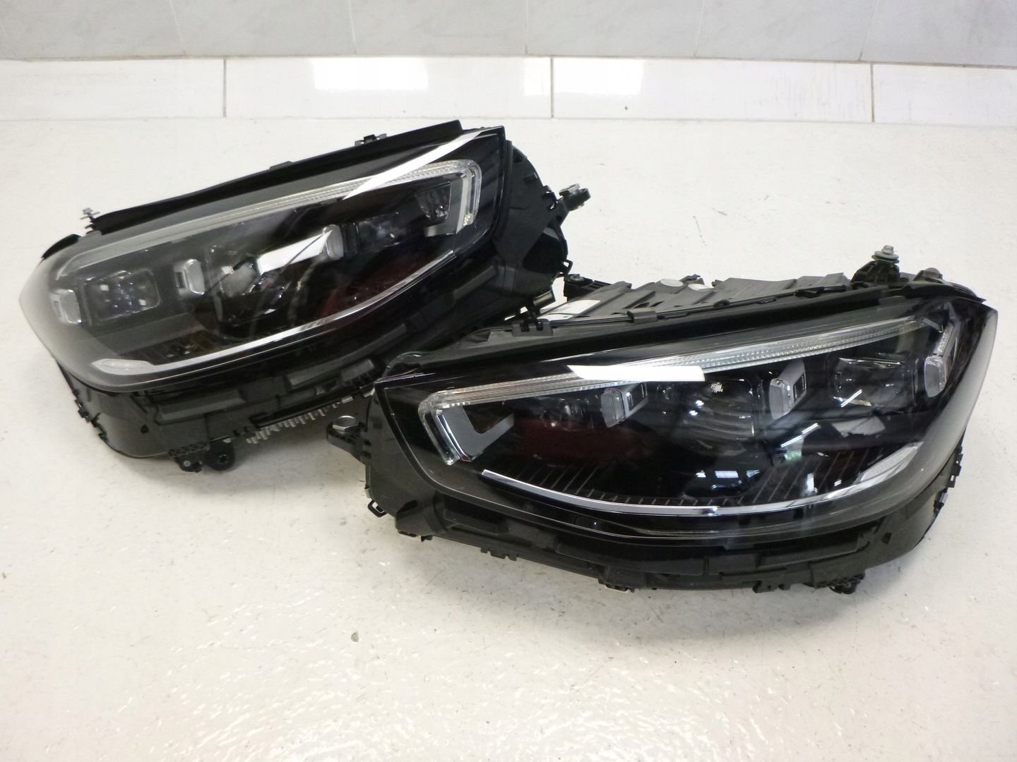

Headlights in 223 has 4 types:
USA Multibeam: 640
USA Digital: 316
ROW Multibeam: 641/642
ROW Digital: 317/318
Both support ILS+, but USA spec need to be coded by EleBest or other coders.
There is “DIGITAL LIGHT” letters on the floor of the light house.
Digital light can be retrofitted and installation is super easy: plug and play in hardware.
so even if you got a car without digital lights you can get it done.

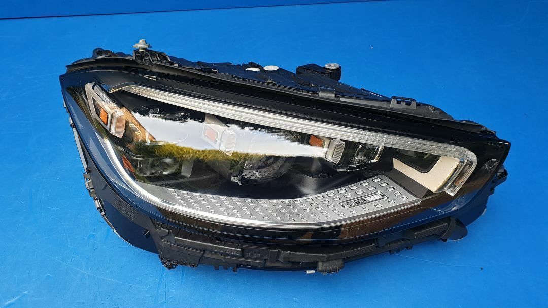

I wish the blue part of the headlight was available in North American vehicles, that looks cool.
It is now. It’s an option as of 2025.

Wait... WHAT??? Pictures please, I look forward to seeing it in person.

If a person swapped out the upgraded Digital headlights for their non-digital lights, does the car recognize the new lights and "turn on" the feature in MBUX? Or is coding still needed to activate the feature with the swapped out lights?
Old Sep 2, 2025 | 09:36 AM
nearwater4me's Avatar
Joined: Apr 2025
Posts: 490
Likes: 205
From: Lowcountry, GA
'25 S580
One of the vendors on ebay said coding is necessary to activate the digital light features.

You'd have to have EleBest code it

Thanks but I am talking about the blue part.
