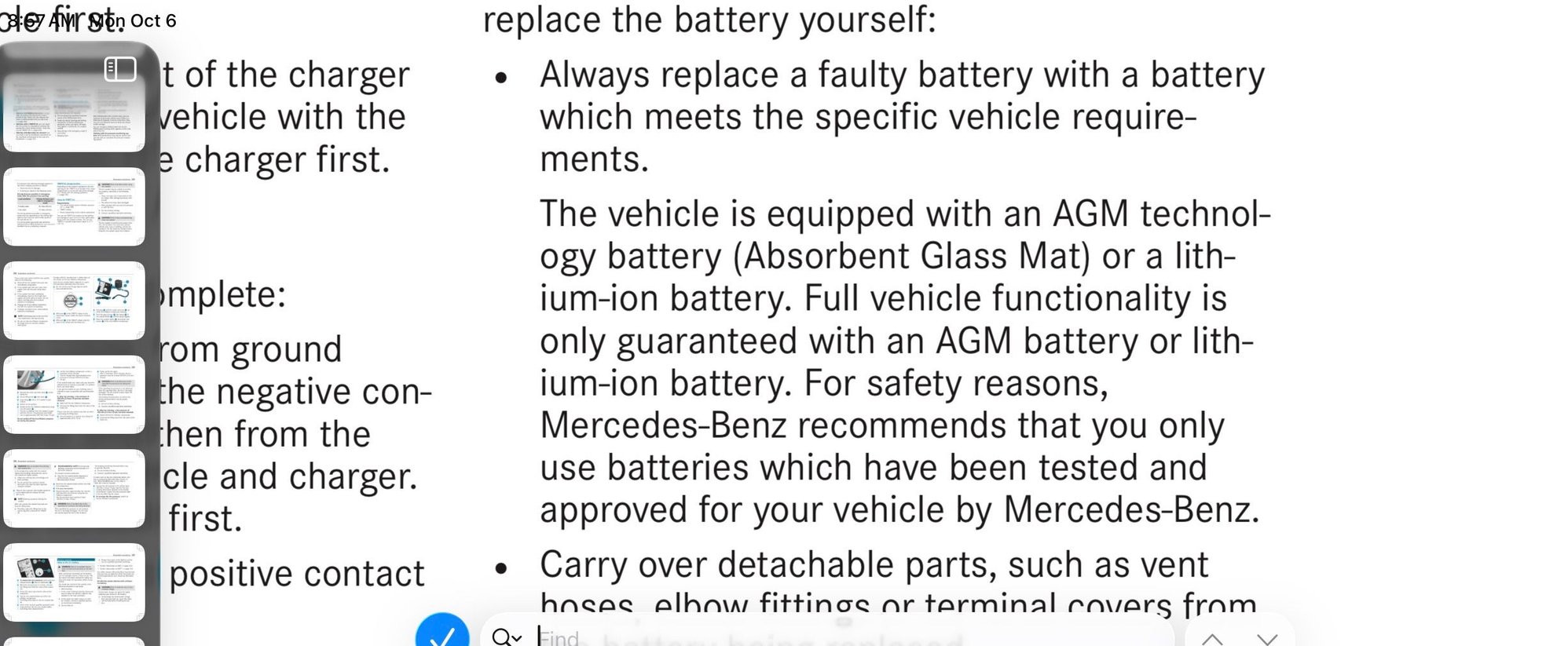

Google isn’t much help as it says it can be AGM or Li. The instruction manual says the same thing: either or. So how the heck can I tell?

[QUOTE=Frenetic;9221005]Google isn’t much help as it says it can be AGM or Li. The instruction manual says the same thing: either or. So how the heck can I tell?
My 2022 is AGM
It is easy enough to see in the trunk unlike the GLE that has it under the driver seat (that one was the same AGM as well in mine). The 48V is Li Ion (I believe) but none of my 12V are
