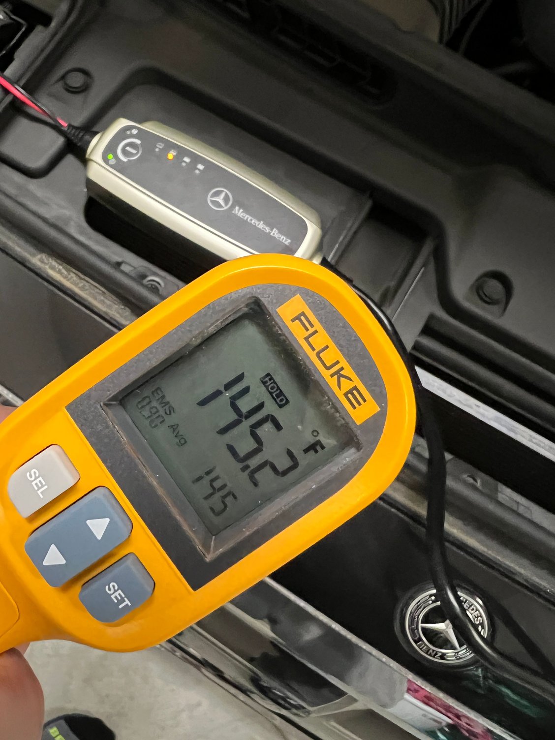

Originally Posted by Frenetic
Also, i noticed the charger gets really warm as well. At least initially, then it slightly cools off (but is still warm to the touch). Is that because of the different charging cycles or should i be concerned as well?
Mine is actually hot to the touch. It’s been that way since I got it. I does cool off as the charging process continues, then when it’s fully charged, it’s cool.
When it hot, the wires are cool, so I’m not concerned.
Warm to the touch is completely normal.
You went from "Very Hot" to just "Hot" in your latest reply so I think it's more of a perception of what Hot is.
When Hot or Very Hot are used to describe the condition of an electronic device, it should be concerning.
Very Hot is Too Hot. Warm to touch is just right.
This is how hot mine gets when the battery indicator is at 50%. It’s hottest near the outlet plug side. Also, my battery was charging for 23 hours but the indicator never went above 80%.. I drove it a little while this morning and plugged it back in and it’s back down to 50% but the app says Charged.
I don’t have a Fluke to check the temp. of my charger, but 145 sounds about right.
