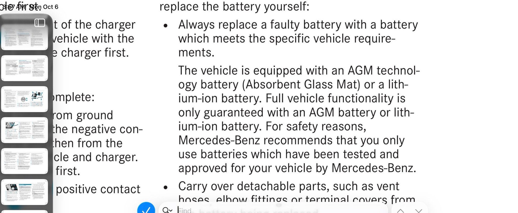

12 Volt Battery: AGM or Lithium?
Is there an easy or obvious way to tell what type of 12 Volt battery is in our cars? According to the owner’s manual it could be either. The reason why I ask is that Mercedes’ trickle charger has two modes: one for AGM and another for Lithium.

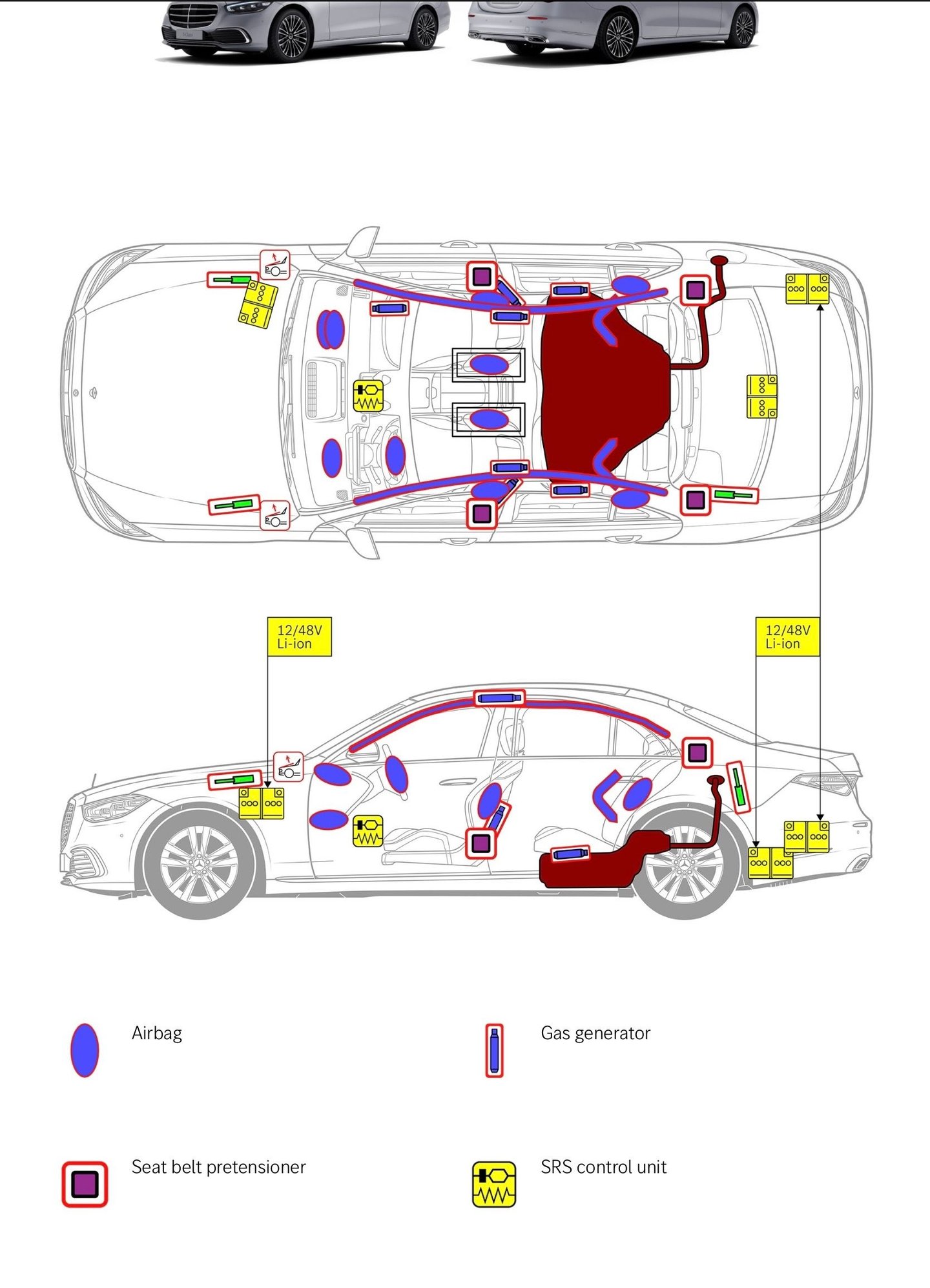

According to this reference from Mercedes, we have TWO 12 Volt batteries and it shows them as being Lithium. Is one a stater and the other Auxilary? Which one is the trickle charger charging?
https://rk.mb-qr.com/en/223.0/

Those two batteries in the diagram aren’t the 48 Volt batteries but are the 12 Volt batteries. I think the fact that they are charged via the 48 Volt battery is why that 48 is there. So, why is there two and why would Mercedes list them as Lithium in these diagrams. And fact of the matter, no one has presented any shred of proof showing the battery in my car is AGM.

Dealership warranty
In the US a 2023 S500 is still under the factory warranty assuming you are under 50k miles. Have the dealership test the battery and ask the service advisor to confirm as the only proof is your battery in your vehicle. If you want proof of the battery and location of mine I can do that but unless you are next door to me as I have no intention to travel to show you and as such I can not provide proof of yours to you.
FWIW the dealership replaced the one AGM 12V in my 2022 S580 that is depicted as the single battery in the center of the trunk in your diagram in 2023 under warranty. I replaced the same exact model AGM battery in my 2021 GLE63S because the dealer said it tested "good" and I was tired of the low and critical battery notifications in 2024. I have a battery tester and it did not test "good" on my tester. It tested at 550cca. The dealer did not say what it tested at other than "good" when it was not. The battery is about $300 at my local dealership parts department.

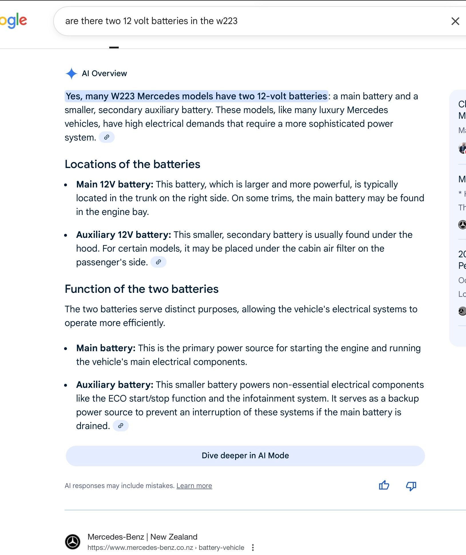

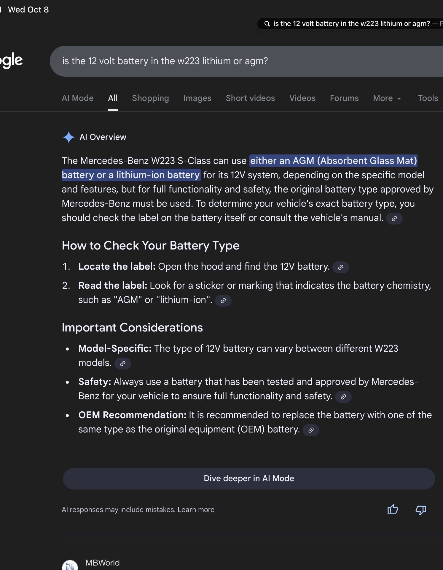

The whole reason I’m skeptical of people just saying mine is AGM so yours is too is because of what’s written in the owner’s manual in black and white. That’s the entire reason for this post…why would they say and write that and for what reason would they list two types of batteries and if it’s true, is there a way to know other than asking the dealership or pulling carpet to see for yourself?
Google has conflicting information as well.

I wouldn't fully rely on AI results. I wish I can turn it off, many times I find Google's AI providing inaccurate information.

YES. Multiple 12V batteries installed. Large Lithium Ion Starting battery AND a small (motorcycle size) Auxiliary 12V AGM battery for accessories.
And yes, they are interconnected through an elaborate control switching scheme for charging and use profiles. Discussed on the forum in multiple threads. Suggest using the search feature.
