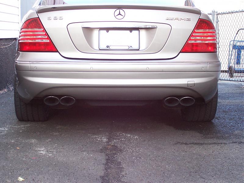

Don't know if this will help but here
Attached Thumbnails anyone have a 55 here :-) need huge favor-tail.jpg

Old Jun 2, 2008 | 08:09 AM
Dragonchaser's Avatar
Joined: Apr 2008
Posts: 11
S 400 CDI
Shaun, AFAICT on the pre-facelift (1999-2003) models the AMG exhaust was single and after the facelift it was a double exhaust, like yours. Nice car by the way, just the way I like it!
