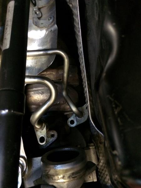

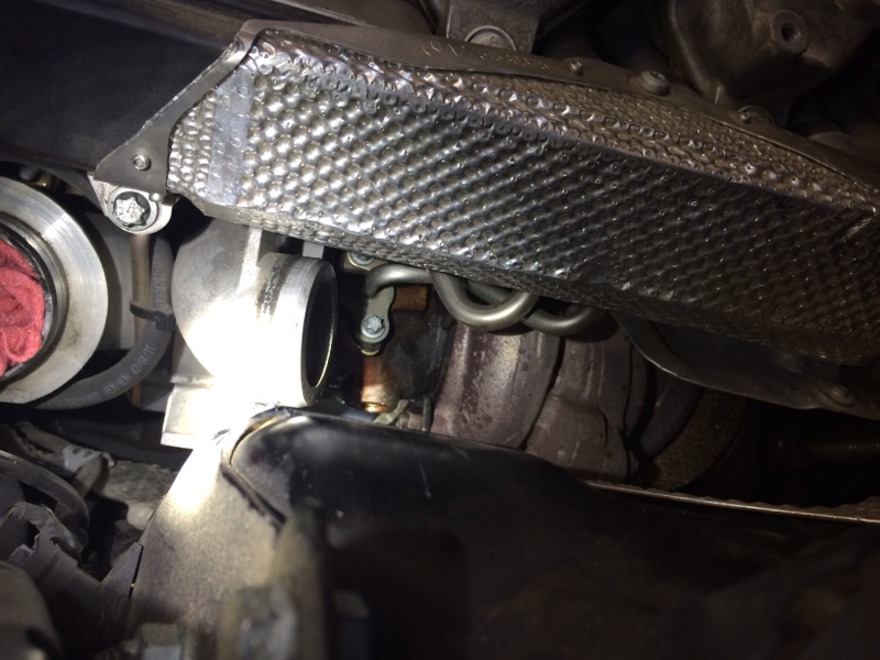

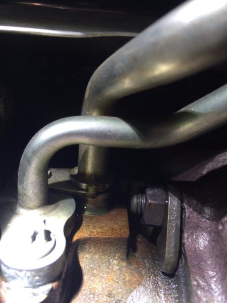

So after seeing coolant on the ground for a week I finally had the opportunity to diagnose it. I pressure tested my intercooler system and there was no drop in pressure. Then I tested the engine cooling system and saw a small drop in pressure. I knew it was coming from the drivers side so I took the airbox out and the turbo out let tube and found it! Appears to be a hard coolant line going into the top of the turbo.
I removed the bolts holding them and can get them out. I think I need to remove the coil pack to get clearance. I imagine there is an o-ring that needs to be replaced.
Anyone experience this?

I have the same issue. Dealer and my Indy say MB does not offer just the seal...and must replace the entire turbo....at $4200 per side (parts only, no labor) What a bunch of bull s@!t. I would be VERY interested in your repair results.

common problem on the M275 TT
there is a seal you can replace.

Coming along, but a total pain in the ***!! Had to remove the coil, unbolt the intercooler hard line, and bend the heat shield. Only to find that if doesn't appear to be just an o-ring, getting the part from the dealer tomorrow I hope so I can finish this nightmare.
