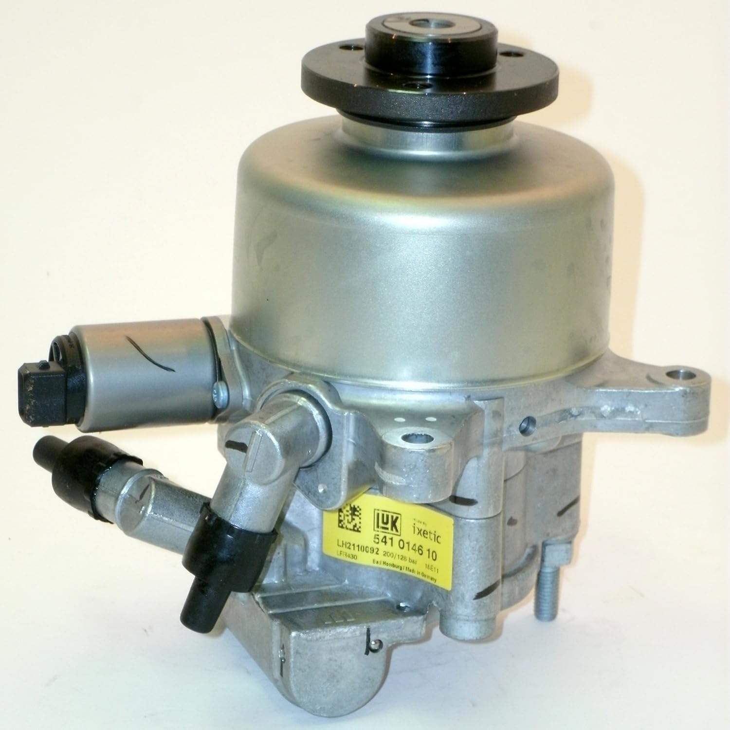

I left the abc sport mode on one night when I turned the car off and then I haven't driven it for about a week then I started it and it was perfect as always drove about an hr and half tops and just when I turned into my neighborhood my abc light came on in white letters I parked turned it off and popped the hood and I see my abc fluid pouring out. Next morning I clean everything and pour more fluid to check for the leak and I believe it's coming from pump. I believe exactly where the pump and pulley meet. Has anyone had this before and is it possible to just pour out right away like that without the car even being turned on? Any help would be great thanks

The ABC pump is a positive displacement pump, and fluid doesn't flow through the pump when its stationary. Only when the engine's running.
It sounds like you need a new or rebuilt pump.
