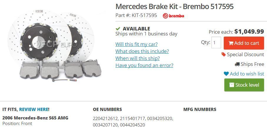

You are welcome. One of the projects on my plate this week is to add some more reasonable priced options for common replacement items for the S65. I added an S65/CL65 front brake kit to the website yesterday located here:
https://www.fcpeuro.com/products/mer...-brembo-517595

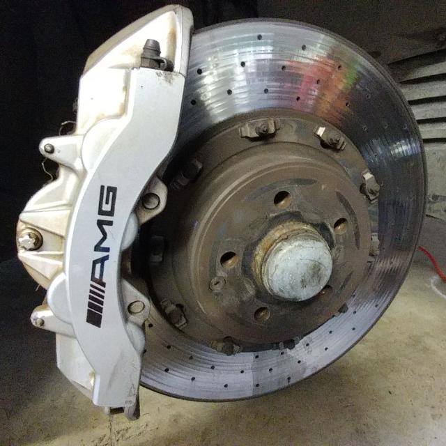

LOL.. Unicorn.. I like that. Very true. Not easy finding aftermarket parts that'll work with this beast; rotors especially. Surprised that RB makes stuff for it.
I'll check out the manufacturers you mentioned. Good price though on the front brake kit from Brembo. I'm surprised to see that they're both drilled and slotted. Weren't factory rotors only drilled?
I'm close to 60k miles on my discs right now. They look decent in terms of wear (mic'd them and they're still within spec) except for heat spots and veins (i don't like the ridges... uneven pads?). Not warped from what I can tell. Still, they'll probably need to be replaced before next summer.

The 2006 S65 had drilled rotors on the front. At 70k miles mine were 1mm above minimum thickness so the dealer installed the 3rd set of pads without a rotor replacement. I sold the car at 80k miles but the current owner will need to replace the front rotors with the next pad change.

Out of all of the two piece drilled rotor cars, the 220 S65 rotors are the least expensive. Never understood why.
