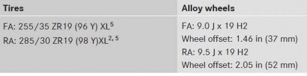

I recently cracked one of my rims and I'm considering switching rims. While looking at other options, I quickly realized I didn't have all the proper information to know what wheels will fit. I know they are are 19" x 8.5" on the front and 19" x 9.5 on the rear. Other than that, I don't know what I'm dealing with. Any guidance would be greatly appreciated.

The wheel info is on back of the spokes the offset will be a number after "ET" for example ET25.

It is on p430 of the owners manual. Front is 44mm, rear is 60mm.

I found that the 20’s on my car when I bought it didn’t push my “like” button, and then found that there were very few options for the ‘06 S65, due to the particular offset it has. I wanted 19’s with a subtle look, and discovered that stock AMG 2014 E63 wheels fit nicely. So pleased was I that I ended up buying two sets
I’m a fan of quality, so I opted for legit AMG wheels, not the multitude of Made in China replicas that are floating around.
Good luck, as the typical “Mercedes” wheel fitment that your average tire ship will suggest, just won’t fit properly.

If the offset is truly 45MM, I suspect the rears will stick out past your fenders by about 8-10MM. I tried a knockoff set, they don't work on our rears. You figure 15MM additional push outside, so hold up a little ruler to the outside of your current wheel and add 15MM and see where you end up. I had some custom 55ET drag wheels made in an 18, and they are nearly flush. Good luck.

My concern wasn't how far they would stick out but I was concerned about rubbing. I didn't want to buy wheels that would not clear the calipers or rub fender wells or anything like that. So far, my welded wheel is holding air.
