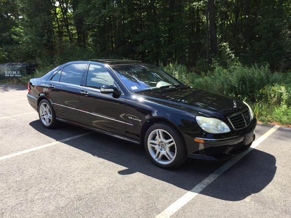

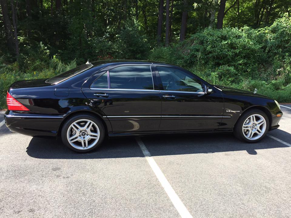

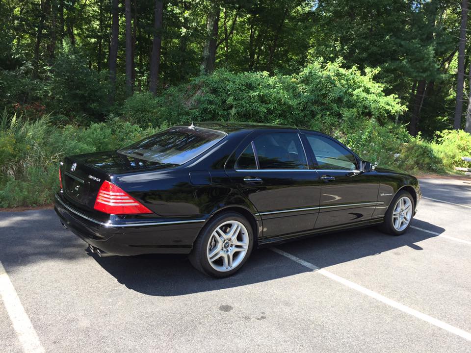

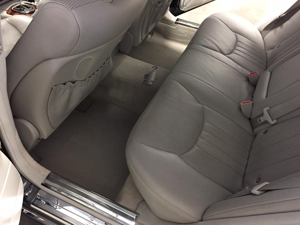

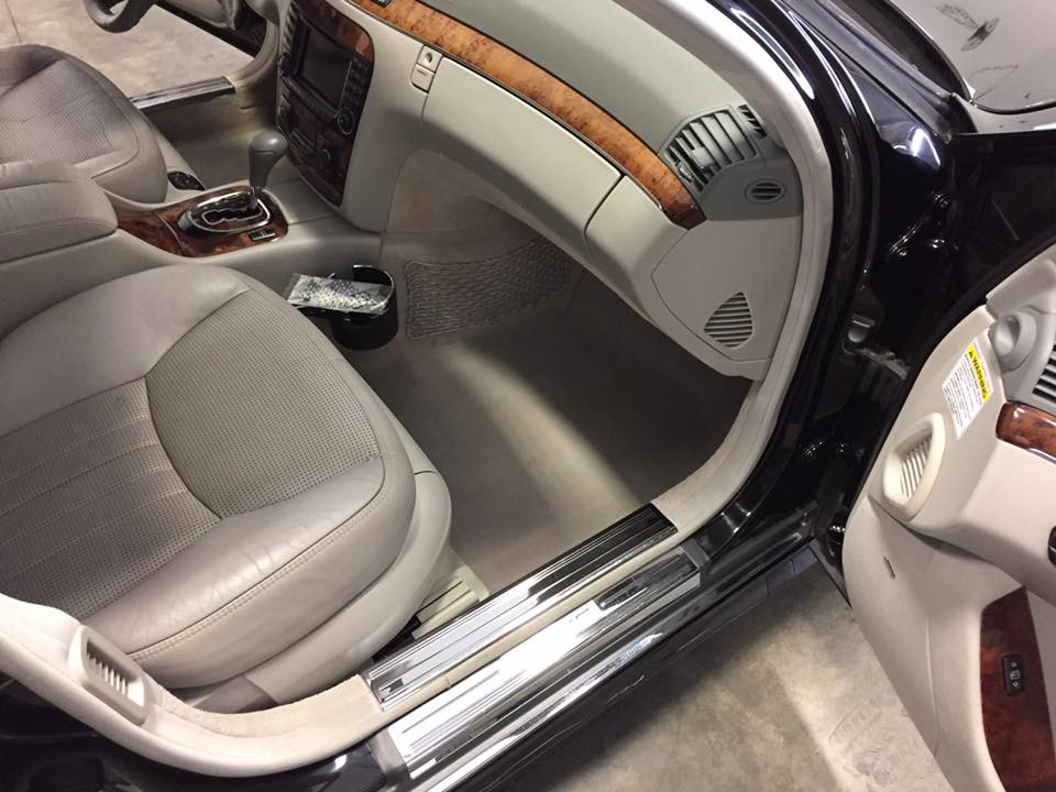

Here are the pics. Another thing I am noticing is with the Tranny. Seems when I am taking it easy on her there seems to be some shuttering at low speed light throttle. Not slipping more of a light back and forth only I can notice it, not sure if maybe a tranny mount issue? Also seems to be starting out if 4th gear based on switching it to manual always says 4th gear? I am planning to do a filter change in the near future and possibly change the plate in there as well but what are symptoms of a tranny mount being bad?
Old Sep 12, 2017 | 09:54 AM
DEBENZO's Avatar
Joined: Sep 2017
Posts: 17
2003 S55 AMG
Sorry here they are..... She cleans up pretty nice, was rough when I picked her up.
Attached Thumbnails New to me S55-1.jpg   New to me S55-2.jpg   New to me S55-3.jpg   New to me S55-4.jpg   New to me S55-7.jpg
