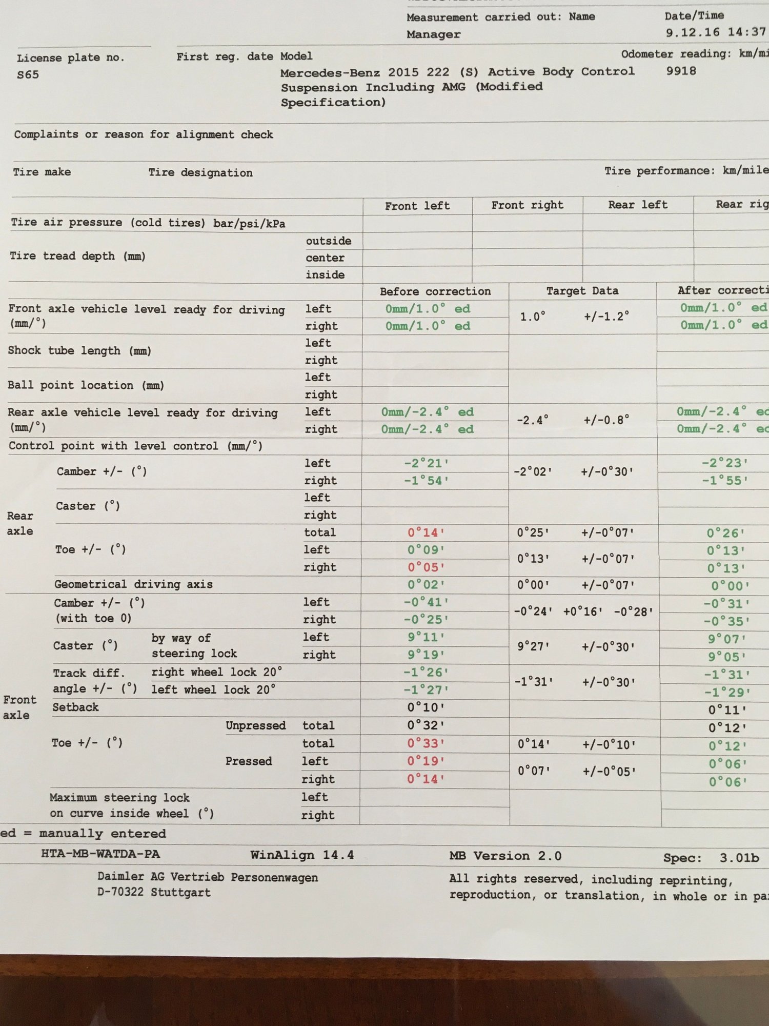

The good news is they fixed the Toe, which is by far the most critical on these cars. It determines how the tires wear and if it pulls left or right. Th camber is not critical, it just needs to be close. The shortcoming in this sheet is the absence of the target data for your car. I have a W222 S65 and I know that some of the AMG settings are different than for the S600. Just for kicks here is an alignment sheet for that S65, you can see the target data in the center column.
Thanks. This is very helpful! Your report is clearly much more comprehensive. Ok so I’m guessing the reason the left front side camber changed slightly after the adjustment was due, at least to some degree, the fact that the toe adjustment on that side was much greater.
I completely agree with you btw, the target data is helpful. The color coding is confusing since in the before the right side front camber is 1.2 and “YELLOW” and after it’s still 1.2 but now “RED”

Note that on my data sheet the tolerance on the front camber is plus or minus 1/2 deg from the target. The target on yours is not specified but the two sides are less than 1/2 degree apart so it should be ok. I believe one of the differences (feature) on the S65 AMG is the Camber is adjustable, that is why there is a target value, unlike the Caster setting which is not adjustable.
