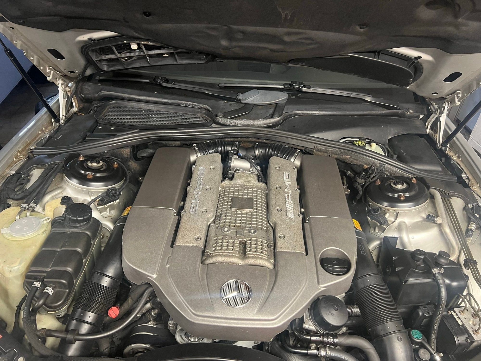

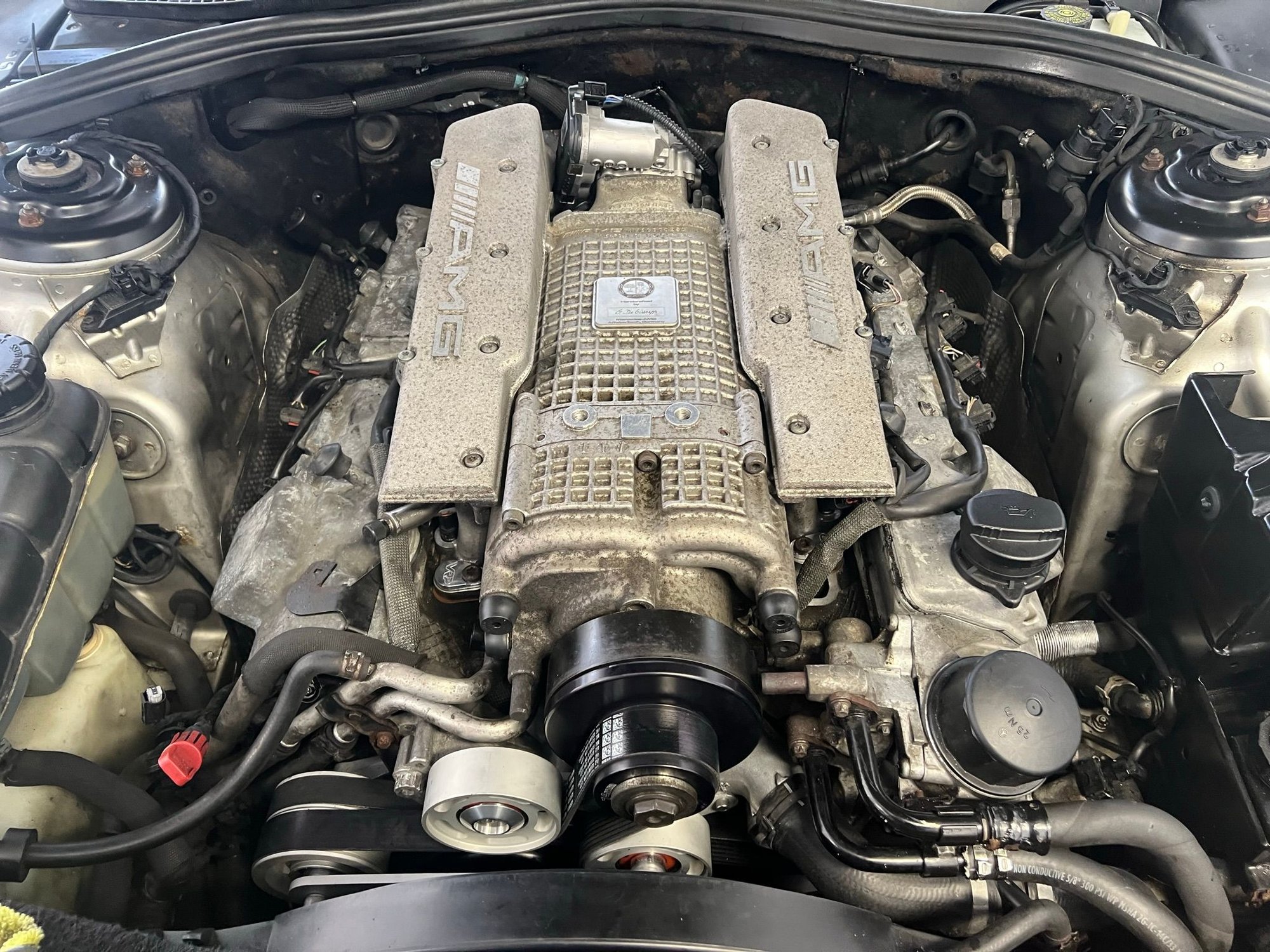

Few months ago I came across a 03 S55 in rough shape and decided to take on this project of making a nice daily driver out of her. She hasn’t had regular maintenance in a long time and was in need of lots of tlc. White ABC light and check engine lights were on. Here is what I’ve currently done and how she sits. Let me know if I’ve missed anything. Thanks
Currently I’ve removed the supercharger and reinstalled with new gaskets.
replaces all the emissions hoses
new valve cover gaskets and resealed the covers
new plugs and wires
new fuel filter
new air filters
new water pump and thermostat
new belts and pulleys
new crank sensor
new radiator and electric fan assembly
all fluids were changed (supercharger oil, oil and filter, trans fluid, rear diff fluid)
trans filter, gasket, and electrical plug
new radiator hoses
new battery
new Bosch 010 coolant pump
new engine and trans mounts( black series)
new cabin and charcoal filters
I also did a few performance upgrades
MBH long tube headers
82mm tb
550cc inj
BWK
74mm fixed pully
Removed the second dairy air injection and rear 02s
Racing IQ ecu and tcu tune
Just got her all back together today. Just needs to flush the ABC system and finish the exhaust.
Going to try and fire her up tomorrow.
The day I picked her up.
How she currently sits.
