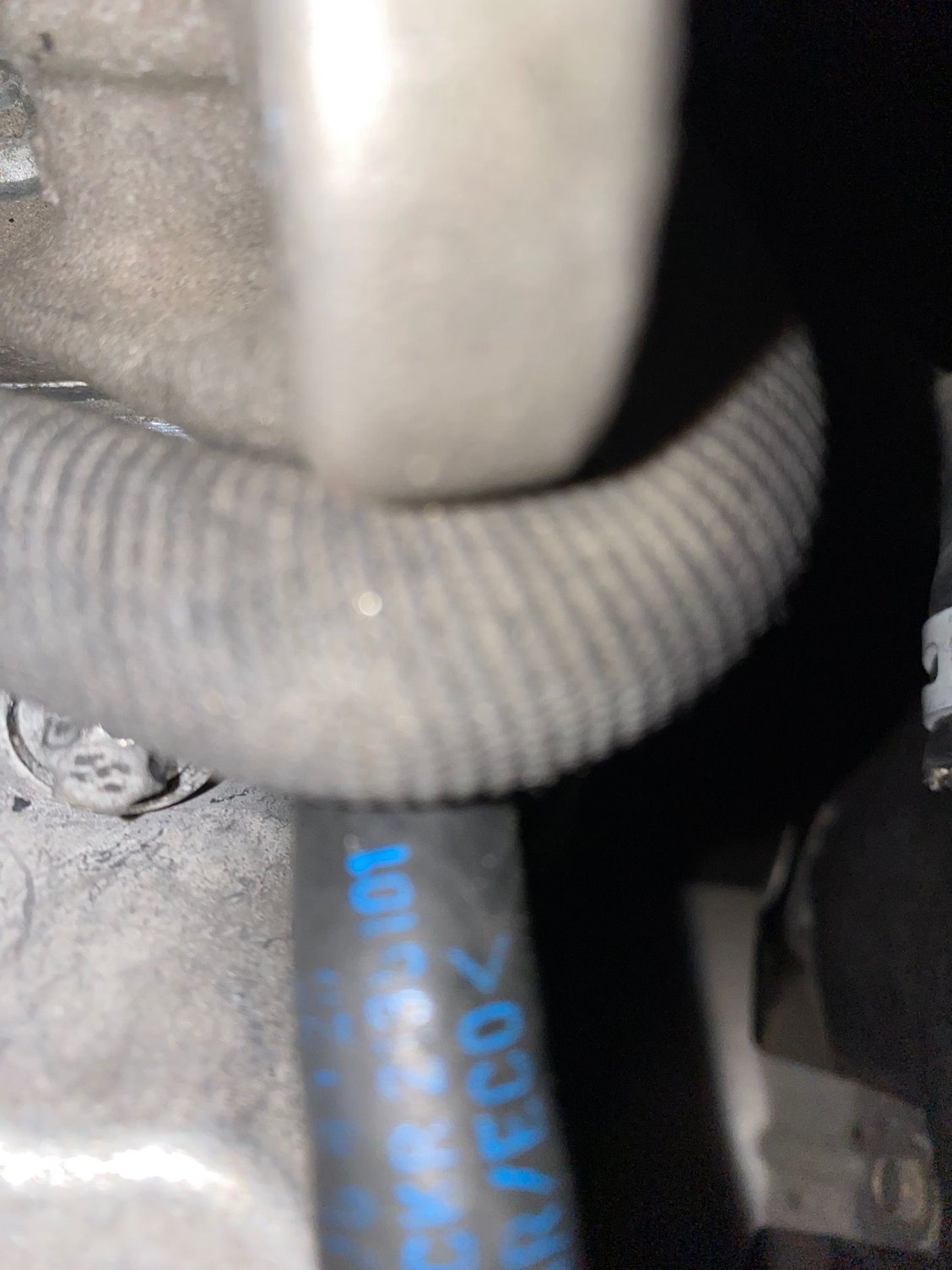

Hello Everyone!
I'm brand new to the site and was hoping to get some help from the professionals. I just changed the valve cover gaskets on my 2005 S55 AMG. Everything went smoothly untill I noticed a metal pipe that was attached to the left valve cover. I was able to determine the hose that went to the front of the pipe but have no idea where the back of it plugs in. I reached out to FCP Euro and they told me it was a breather pipe, sent me the diagram but said the diagram did not show where it was connected. I am attaching a picture of the pipe, the diagram (it's #152 and 158) and the hose that plugs into the front but I need to know where the back plugs into. There is a piece of hose connected to the back so I am assuming it must have broken off.
Thank you all in advance for the assistance!
Robert

Under the supercharger at the rear of the intake… see here… https://mbworld.org/forums/s55-amg-s...3-s55-amg.html … easier to do with the engine cold, obviously… common miss.
GL
maw

That's exactly what I was looking for. Thank you so much!! I can't tell you how much that helps!!
