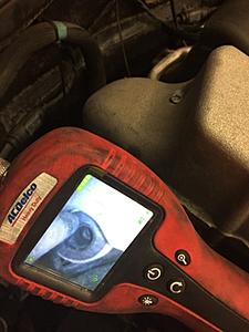

it turned out being the line under the supercharger. i thought that it was connected to a hose and didnt know that it went directly into an opening. I couldnt get a good view so I ended up using a borescope to see where it went.

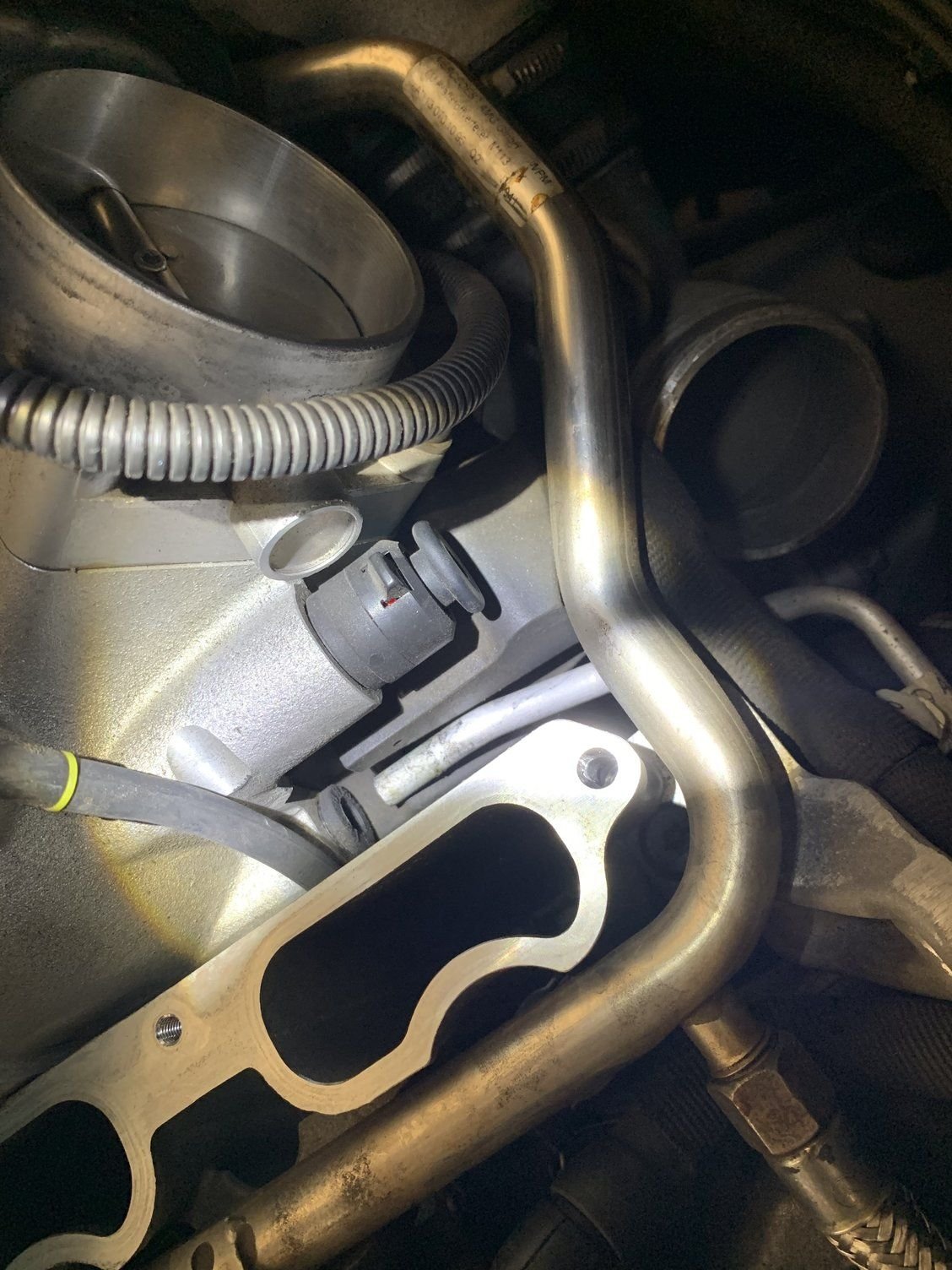

The infamous vacuum leak after changing valve cover gaskets. Even Mercedes Dealerships can make this mistake.
Look at the picture.

Yup... that’s the one... someone here was looking for it a couple weeks back. Thanks for the pic.

Not my pic but had I taken one during my work on my E55 it would have looked just the same! It seems that dislodging this pipe is VERY common when replacing valve cover gaskets.
