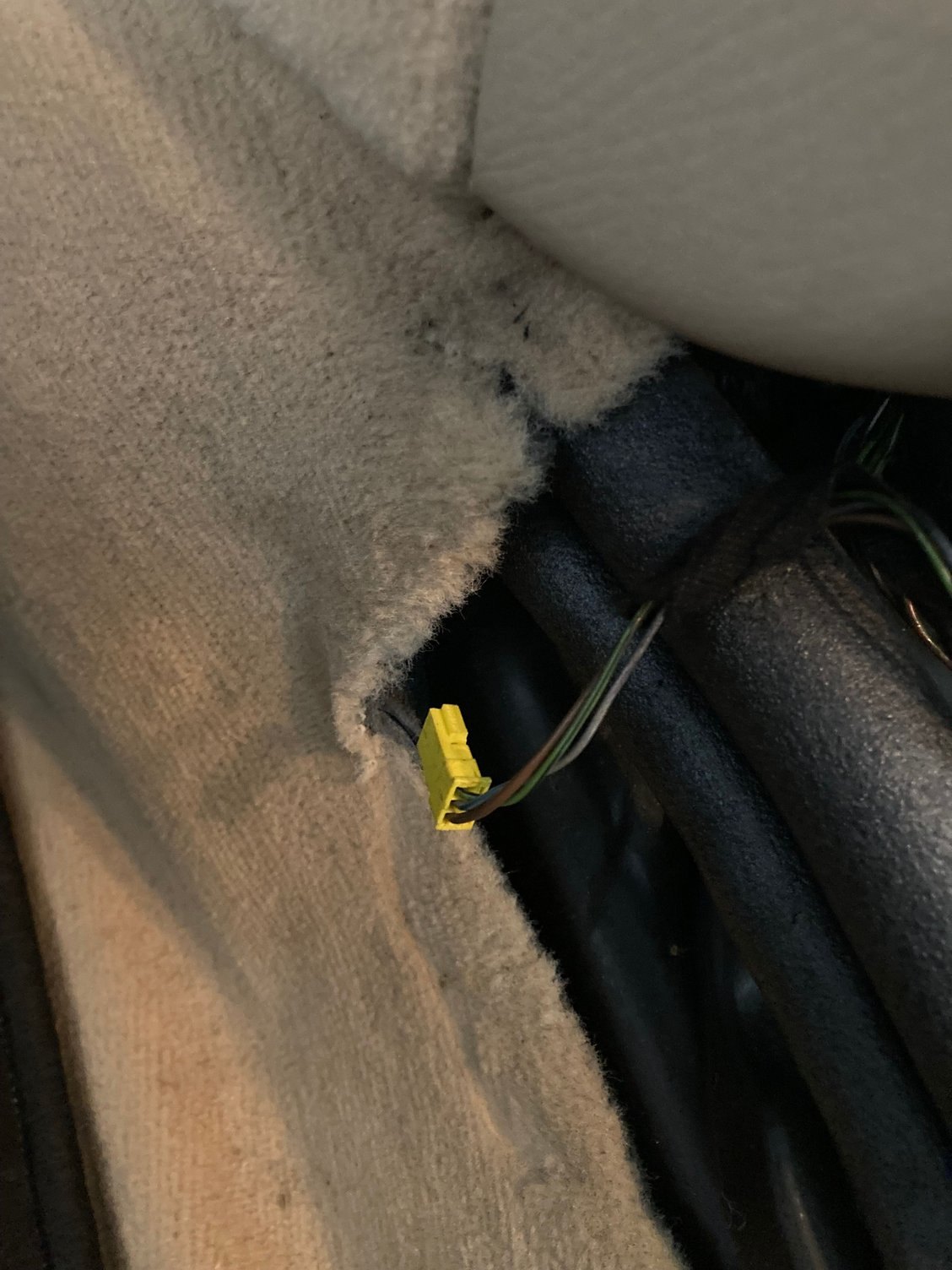

Before I dig any further into this, is there any reason why someone would intentionally unplug this harness to the cover that houses the C/S button on the shifter....like trying to hide or bypass a problem? I pulled the cover to see what's going on and the harness is literally nowhere to be found unless it's tucked away really well. I believe there's a yellow plug that should be plugged into this. There's no illumination to the gear selector either. Any input is appreciated.

could have been someone who replaced the shifter assembly due to a faulty unit, or trying to diagnose a bad brake switch and forgot to plug it back in. I can't think of any reason someone would purposefully leave it unplugged.

I wondered about that myself. I hope it’s just hidden somewhere and not cut.

I finally got around to lifting the console, low and behold I found the harness tucked underneath the driver's side of it. Apparently the last time it was out they missed the harness and didn't bother trying to plug it back in. My C/S button is functional now and no more taking off in 2nd gear. I love an easy fix!
