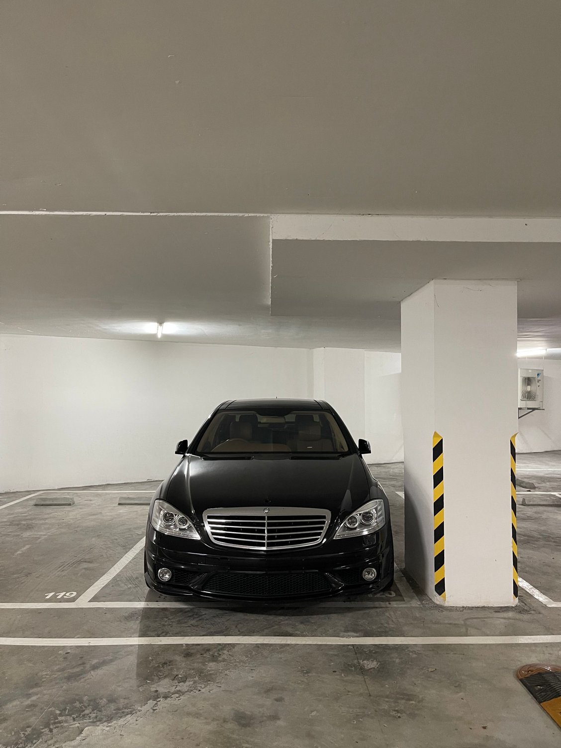

there’s so little information out there of the w221 S65 and we decided to get one!
appreciate any headups for tuning this beast!

Beautiful car!
Unusual to see one with the pre facelift kit but with the facelift mirrors and headlamps.
Any more pic's of the car?
As @maw1124 said, don't tune it.
Imho, they are very fast cars already. I own an S65AMG just like yours. It's easy to get this cars to 700+bhp but I haven't felt the need for more power.
Just make sure you maintain it properly and you will love the experience of the S class with a V12 under the bonnet. My one still puts a smile on my face every time I drive it

OP.... Where did you come across that one?
It looks exactly like my previous 221 S-65.
Same size tires front and rear? Brembo front brakes with rotors on hats? If so you are in for a treat.
Maw accumulators are not such a common failure in the 221 cars. Though the little nitrogen bomb that threads into the ABC pump fails every 2-3 years.

Hello sir!
Got the car here in Malaysia.
It’s still running with stock brake kit which I planned to upgrade later!
Noted on the nitrogen bomb tips!
