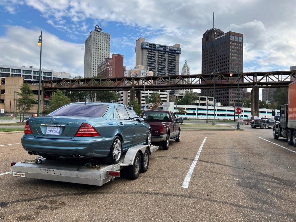

The day I picked it up! About 800 miles from home in Stafford, TX.
Obligatory tow rig picture. If the S55 has problems I can at least rely on this sub 150k mile 7.3.
I was surprised to find the Tennessee welcome center was located right in downtown Memphis.

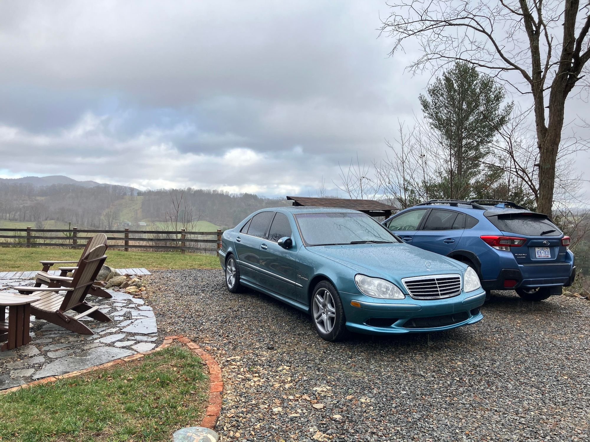

About 400 miles to the mountains for Thanksgiving. No (new) issues. The car drove great and it's going to be too easy to get into trouble. But I'm loving it! Got over 20mpg, but did noticed that the trip computer woefully undercalculates gas mileage. It starts under 2 when you start the car and just get moving and then never comes up at a quick enough rate.
It's going to get well under freezing so it'll be a good chance to see if that causes any problems the next couple of days.
