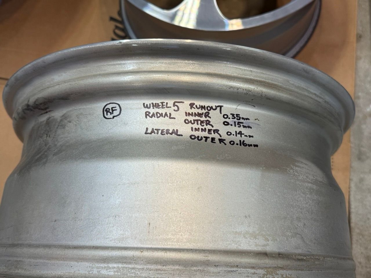

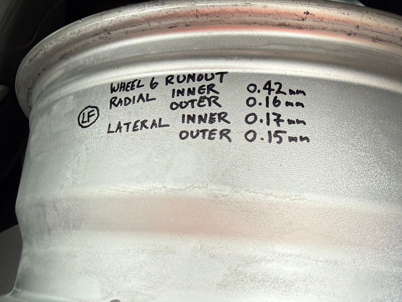

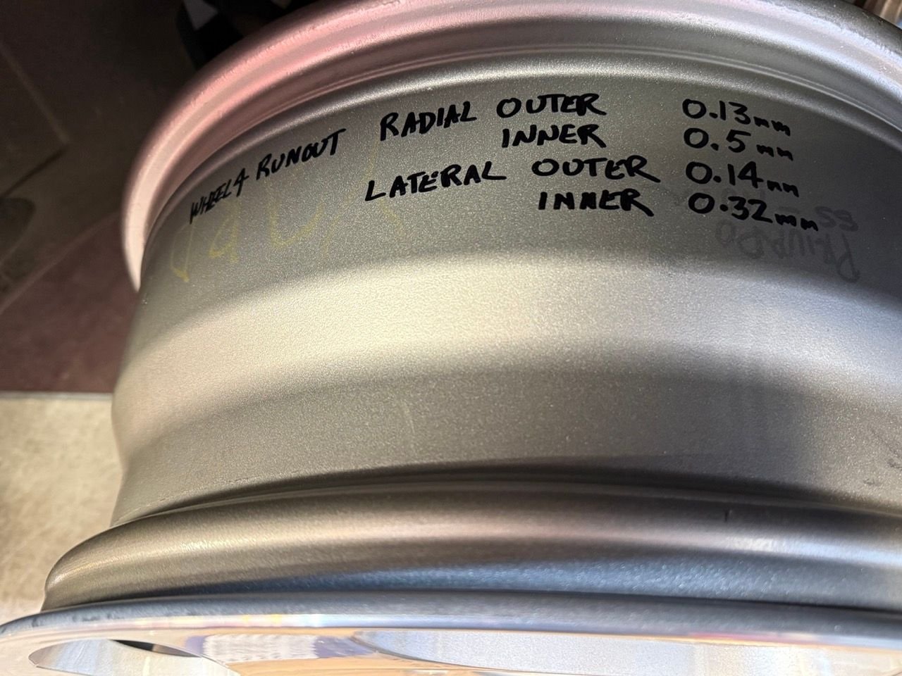

Thanks @JohnLane and @maw1124. Indeed I measured lateral hub runout at 0.04mm so that's pretty good.
@JohnLane I should have measured runout on my refinished 18x8 Forged MB Segin wheels before I mounted tires on them and roadforced them..... but I did not. Lesson learned.
I will bite the bullet and dismount all the wheels and tires and measure runout on all those wheels.
In the meantime I have ANOTHER 4pcs of Segin 18x8 wheels that I refinished that have not had tires mounted on them. I measured three with good runout and one with JUNK runout .... so now I know I have three spare wheels that are good.
Here is the 4th JUNK runout spare wheel that I have for reference - 8mm runout on the inner barrel and 2.5mm runout on the outer barrel!

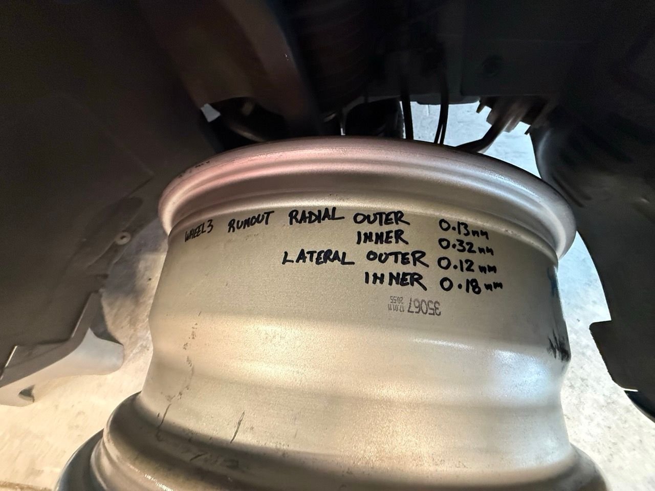

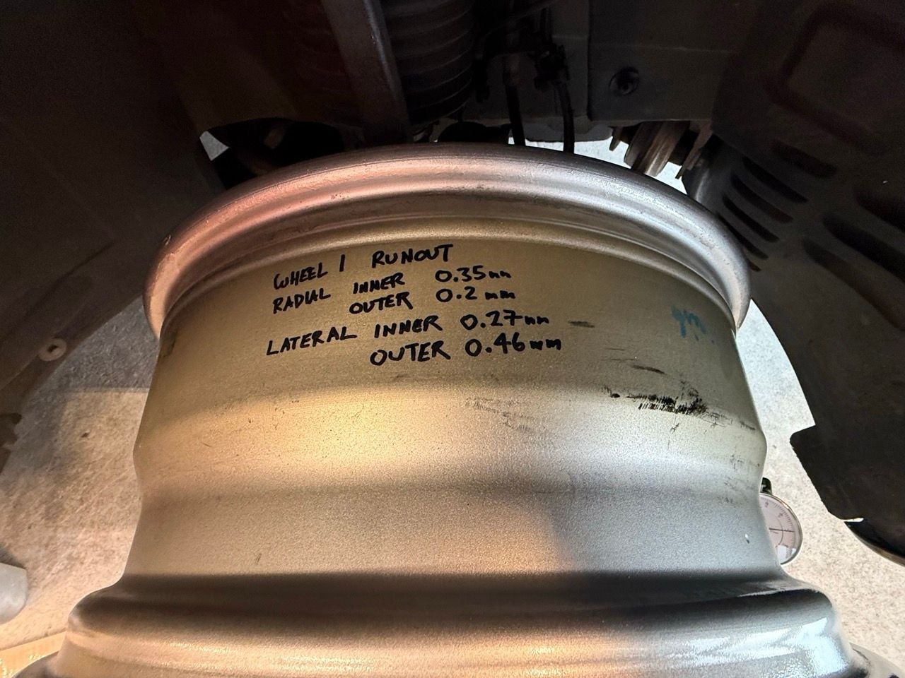

OK, I'm gonna take the wheels over to the shop and have them dismount all the tires. Then I will bring the wheels home and take my time and spend a day to measure runout on all 4 wheels -
- Lateral - Inner
- Lateral - Outer
- Radial - Inner
- Radial - Outer
The following day, I will choose the 4 best wheels (out of 4 on the car and 3 good spares) and bring them back to the shop and have them mounted, balanced without using smartweight, and roadforced.

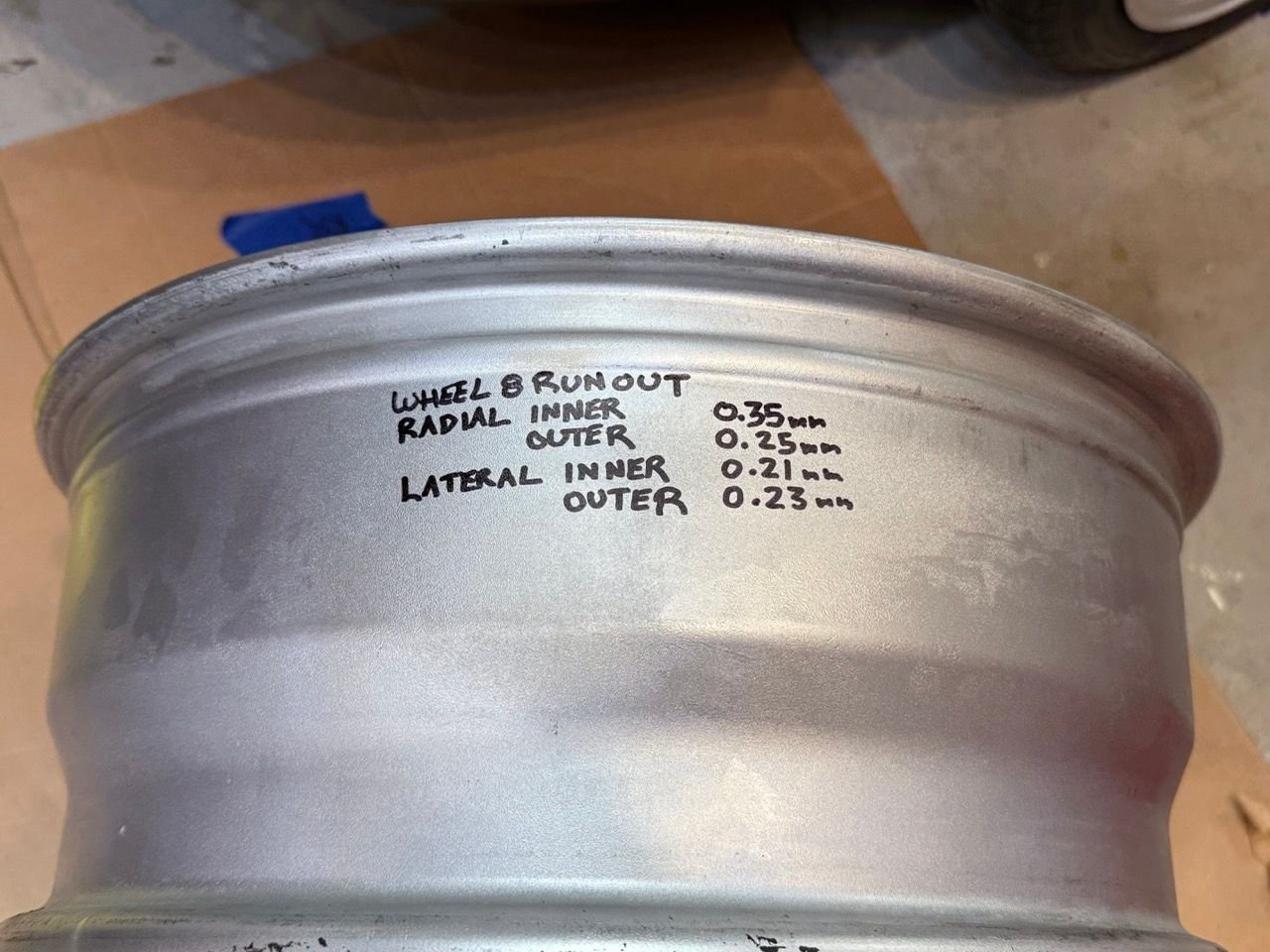

Progress --- I had the tires dismounted from the wheels. I brought the wheels home and I measured the runout of all four wheels with my dial gauge. They actually look pretty good -- you agree?

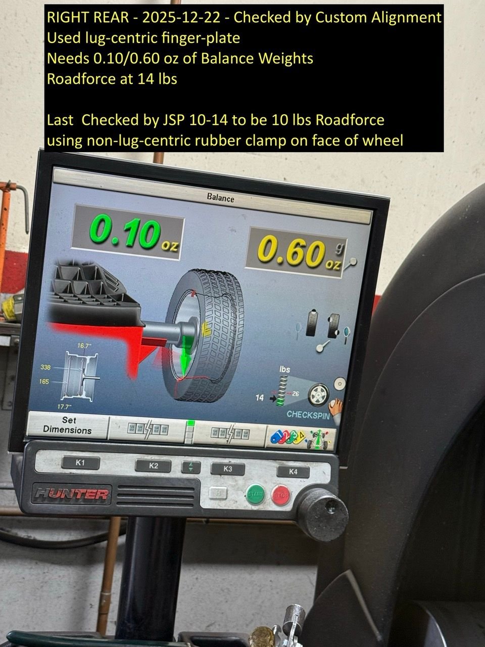

This shop is the most professional tire/wheel shop I have used so far --- they insist (properly) on using the lug-centric finger-plate device to secure the wheel to the GSP9700 (not using the rubber press-the-wheel-face-to-the-machine that most shops use).
They checked the roadforce readings and the balance of the wheels before dismounting the tires. Note that this shop likes to balance within 0.10oz instead of the more common 0.25oz that most tire shops use. I find it interesting that this shop says my previous shop didn't balance that well and that this shop found roadforce values that were somewhat (but not grossly) out of whack. Maybe its because the previous shop did not use the lug-centric finger plate.
In the next couple of days, I will bring the wheels back to the shop, have the tires mounted back onto the wheels, re-roadforce and rebalance. If the vibrations are still there then the vibrations would DEFINITELY NOT be wheel/tire related.

Vibrations solved finally! The last step the re-balance of all four wheels (that I verified all had great runout numbers) w tires mounted. The balancing shop:
- Got down to 0.10oz of balance, not just the usual 0.25oz
- BACK Coned the balancer
- Used a SHALLOW angle collet at the back
- Used the finger plate clamp device to clamp the wheel on the balancer using the lug holes on the wheel
- NOT a rubber cup that presses the wheel face
- NOT a front cone that presses the center bore hole of the wheel.
This w220 is SUPER SENSITIVE to wheel imbalance --- perhaps even more so than my w124, which is already super sensitive.
I'm pretty sure the reason I fought these vibrations for so long is because there were several issues that contributed to the vibes - the RF bent wheel that I replaced and the wheel balance.
Note that my final roadforce values are:
LF 2lbs
RF 9lbs
LR 15lbs
RR 24lbs
