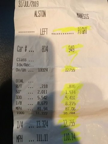

So, this past Wednesday I took my car (2017 s63 amg coupe) to the dragtrip and am a bit disappointed in the performance. The best I could muster out of it was a 12.7. From what I read in car magazines they had these cars running 12.0-12.2. I tried launching the car in sport mode with brake torquing with slight boost at 2500rpm but it feels like the transmission hesitates for a second then launches. I also tried just smashing the pedal same thing there is a lag before it starts to run. The best time (12.7) I got was when I turned off all traction control off and just smashed the accelerator. I have read on these threads that the transmissions on this car do have a slight hesitation but what I am wondering is then how where these magazines getting these1/4 times. is there a specific way that these cars should be launched off the line? Full size sedans are rifling off faster times then this. Any input would be appreciated.

Post the slip. What was the 60 ft?

60ft was a 1.974

OP has a 2017, there is no Race Start / Launch Control. C&D tested a 2018 were which has a completely different drivetrain (M157 > M177, 7sp > 9sp, 4MATIC>4MATIC+) and new software which adds Sport+ & Race Start, and better Michelin tires too.
But a 12.7 @ 110mph seems way too slow for a 2015-2017 suggesting that something is off with the car. ET should be around 12.0 @ 120mph. So I'd get it checked on a dyno. If it isn't putting down rated power then bring it to the dealer along with the dyno and slip proof; being a 2017 it is still under factory warranty.
