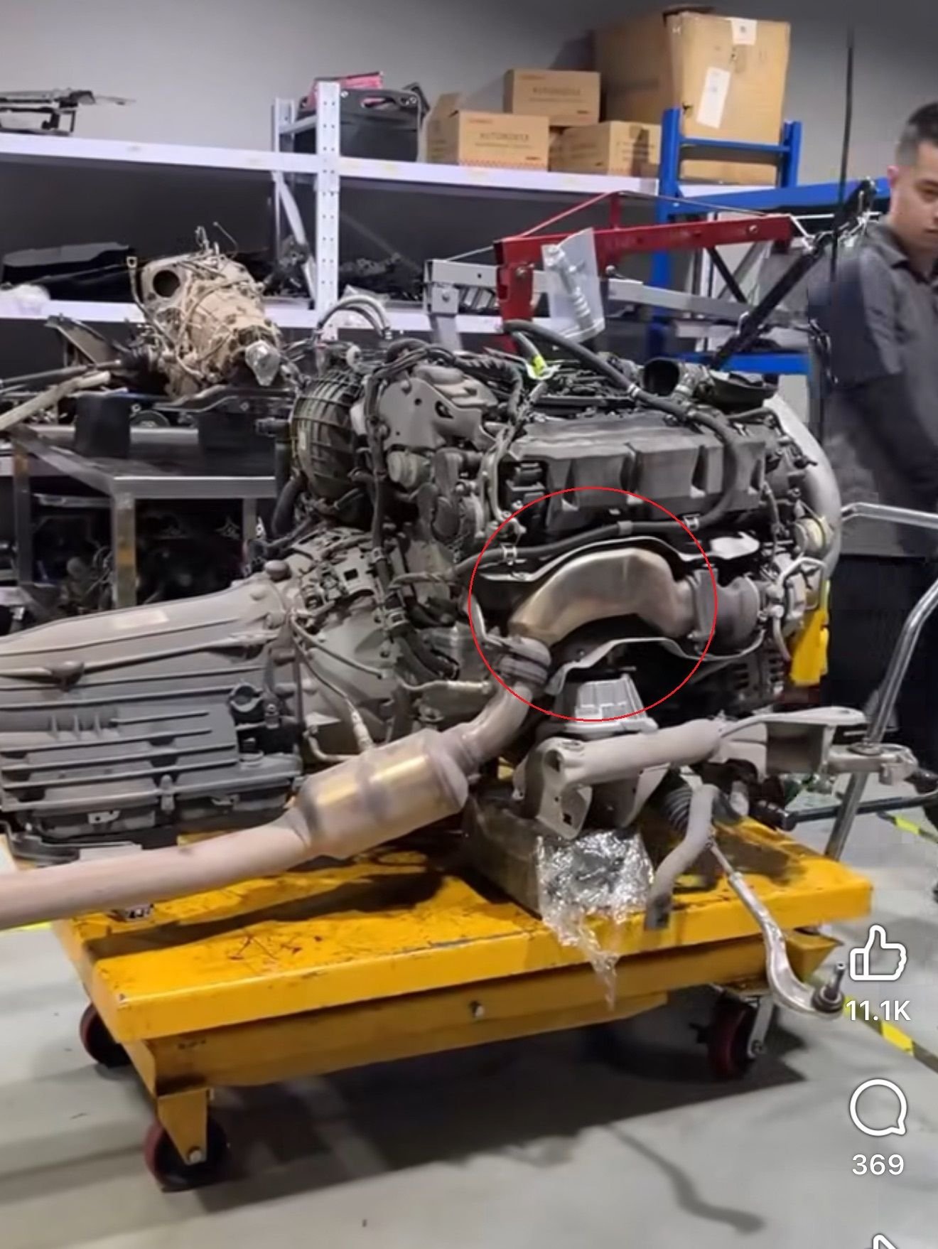

Some interesting facts...
- Everyone who sells "downpipes" for our application are actually selling midpipes
- The downpipes are SQUISHED and contoured to fit against the engine block, and as such, are very restrictive. Only way to change them out is to either pull the motor, or drop the subframe. You can see why from the pic below.
- The midpipe (that everyone sells) starts right past that, and is accessible from under the car.
Weistec actually sells a DP that'll fit the car (standard for all M157 engines I believe). "For the coupes/convertibles, the downpipes themselves bolt right on, but the midpipes may need modification to fit properly." They insist "midpipes from third parties are not compatible with our downpipes. The downpipes alone would require that you completely custom make midpipes. It is far easier to modify supplied midpipes than make whole new ones."
When you look at the photos they have of the side-by-side of the OEM DP vs their aftermarket DP, you can see why it's not compatible with other aftermarket MPs; their DP is much longer than the OEM unit.
In case anyone is ever interested, here's the product link to the DP + MP combo (MP will still require modification): https://www.weistec.com/m157-downpip...sedan-awd.html. +183 HP & +252 TQ increase with ECU tune. No slouch mod, that's for sure. But at $4400 for the parts alone + say another $500 for modifying the MP + labor for dropping the subframe (totally guessing; lets say a grand), at $6K, that ain't cheap... About $33/hp gain...
