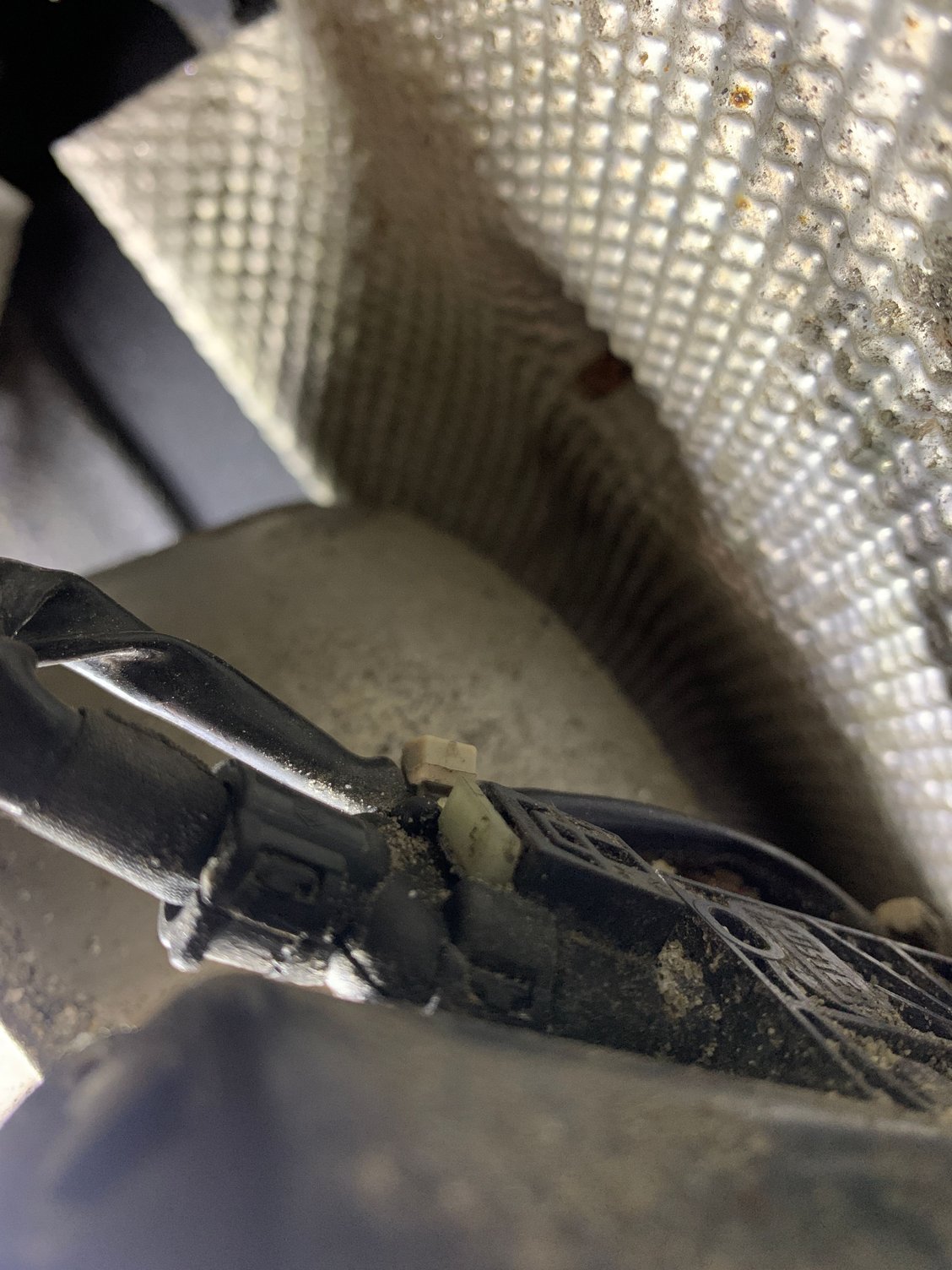

Has anyone here unclipped the exhaust valve clips on the S63 Exhaust? I’m trying to install the ASR/Renntech exhaust valve controller and can’t figure out how to get the stock clips disconnected. Trying not to have to remove the bumper to do it - but it’s tight access. Here’s a picture of the clip. Pressing on the white part and pulling isn’t working. I read the A45 has a clip where you need to pull that white part out and then press on the black part - but I haven’t been successful pulling the white part out.
Any tips?

Cut the zip tie off. The white/grey part slides to the left (in your photo) to unlock and then can be pushed down to remove connector. It is very tight and a pain in the *** doing it on the ground

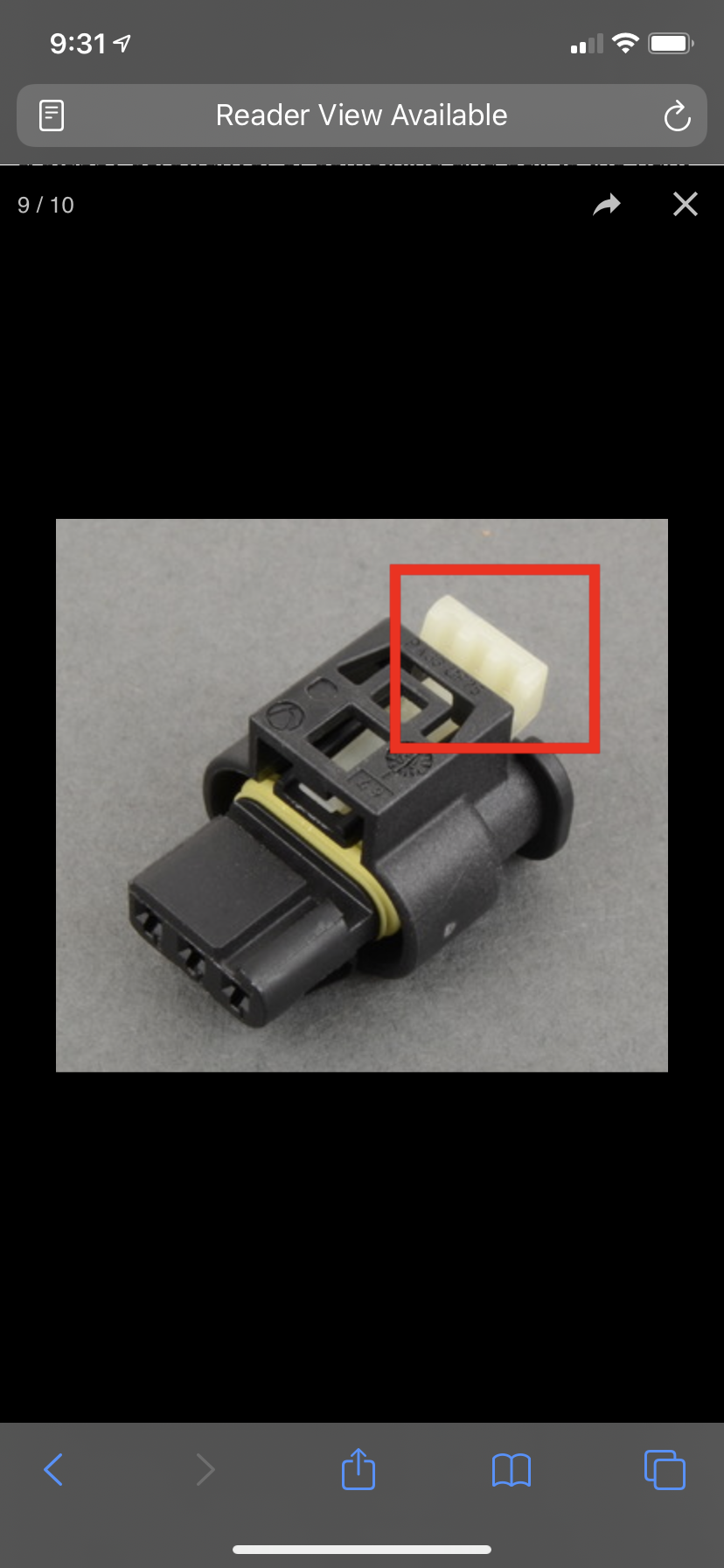

I’ve got the white clip popped out on each side (one came out completely - the other unlocked) but still can’t get the connectors to come off. Where do you push? Here’s a better picture I found of the connector.

Push and hold the white tab down towards the wires inside the connector. Pinch it between your pointer finger and thumb then slide connector off of the flap motor at the same time

You need to spry some WD40 on the connectors. Also need to put in some elbow grease because it’s stuck in there really tight. Seeing it done in person. Using a small flat head screwdriver helps allot.

Finally got them off! They are a pain. I found that you do need to pull the white tab outwards - but after that you just need to pull and wiggle the connectors for a while until they come out (and with a lot of force). I don’t think squeezing made a difference. I was successful getting them off when I focused more on pulling and wiggling than trying to squeeze somewhere. I did it from the ground with the suspension in the lifted position - it was tight and the angles were awkward. It would likely be a lot easier if you have the car on a lift. Exhaust valve controller works well - will get to test it driving tonight.
