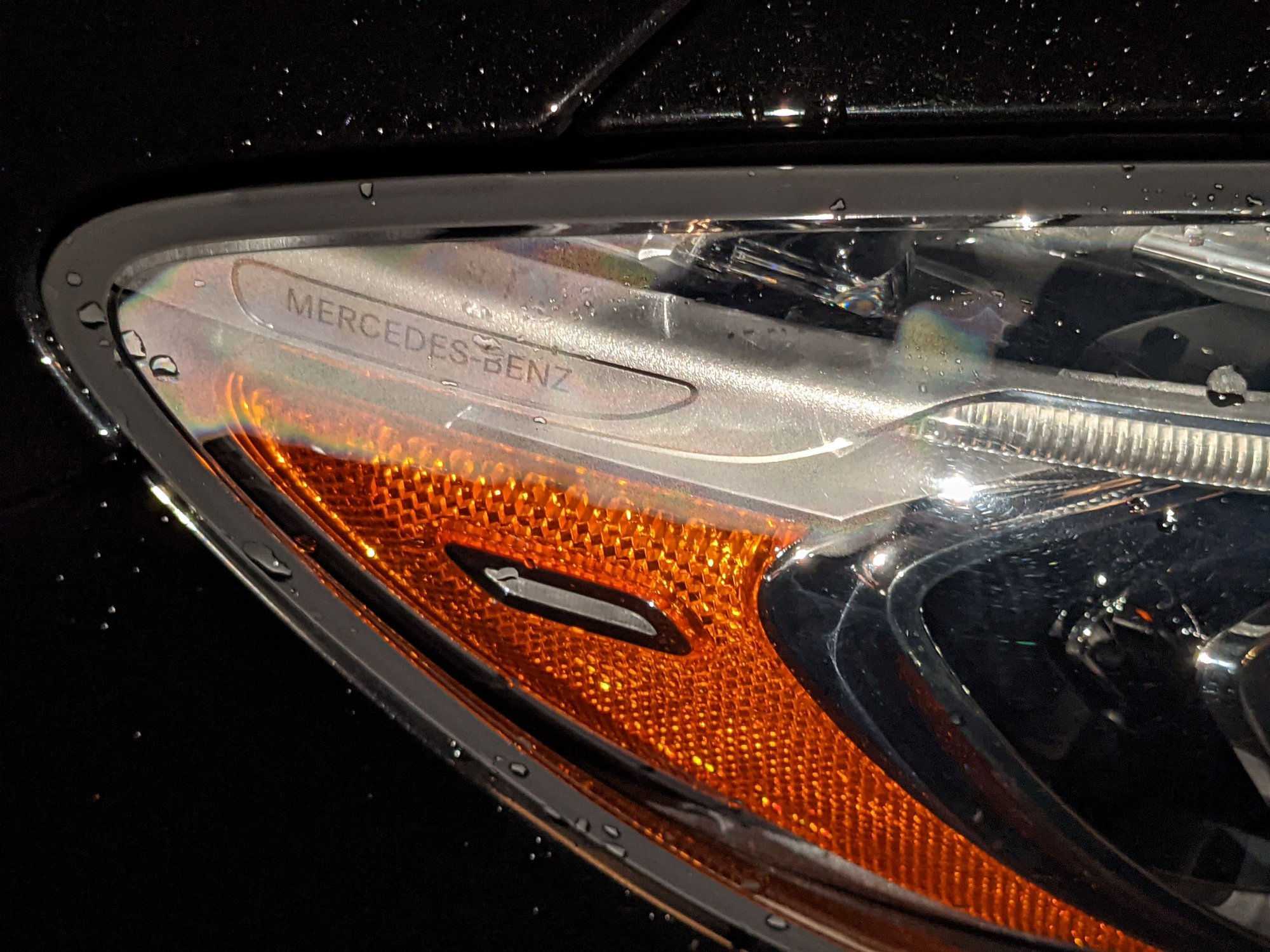

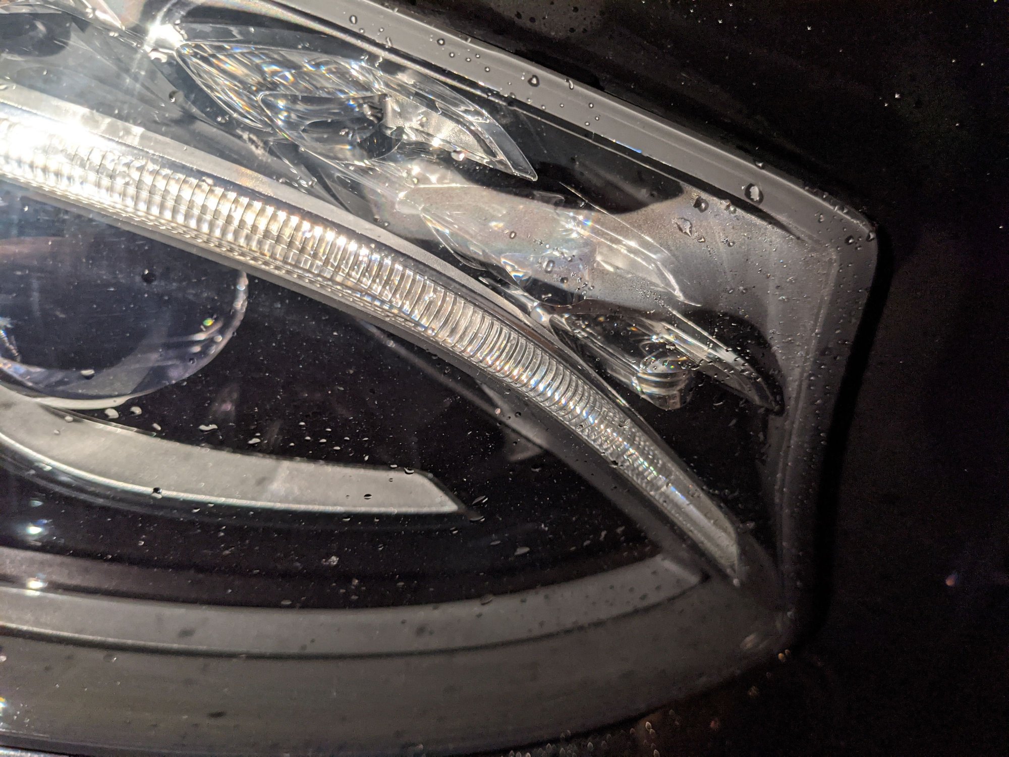

Just acquired 2019 s63 coupe and noticed after a rainstorm that the headlights are fogging up on the inside. Can anyone confirm if this is normal or not?

I don't think that is normal, it might even fail a state inspection.

It happened on both headlights and when I checked this morning they were gone even though it was still humid out.
Did not notice anything on the rear tail lamps.
I'm going to try sending to my service advisor see what he thinks

It happened to me also on my car many times. It always happens when there is a rapid change of temperature within a short time - for example light covers are hot from the sun and you wash your car with cold water, or you wash the car in the heated car wash during winter and then you put it outside to a freeze.
It always disappears within a few hours. If it does not happen regularly without a reason above, I think it is fine.

all headlights have a couple small holes in the bottom to allow moisture to escape. If not it would stay there forever. Dont know any solution. Some get more moisture more than others. Maybe complain to the dealer

same thing to mine exactly .. i think it’s normal .. or i hope so anyway .. as long as it doesn’t happen without the rapid weather change
