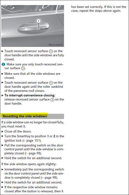

Old Mar 17, 2023 | 02:57 PM
konigstiger's Avatar
Posts: 15,901
Likes: 4,630
From: North Scottsdale, AZ
'71 Pinto
Old Mar 17, 2023 | 03:17 PM
S63C4's Avatar
Joined: Feb 2015
Posts: 135
Likes: 26
From: New England
2016 S63C4, 2021 Escalade Sport Platinum, 2023 Polaris Slingshot R
Thanks for the procedure. I'm not sure it's that simple because until I started messing with the back window, then the front again, then the back again and on and on, somehow it eventually reset. Hopefully this archive will be completely useless. LOL.
