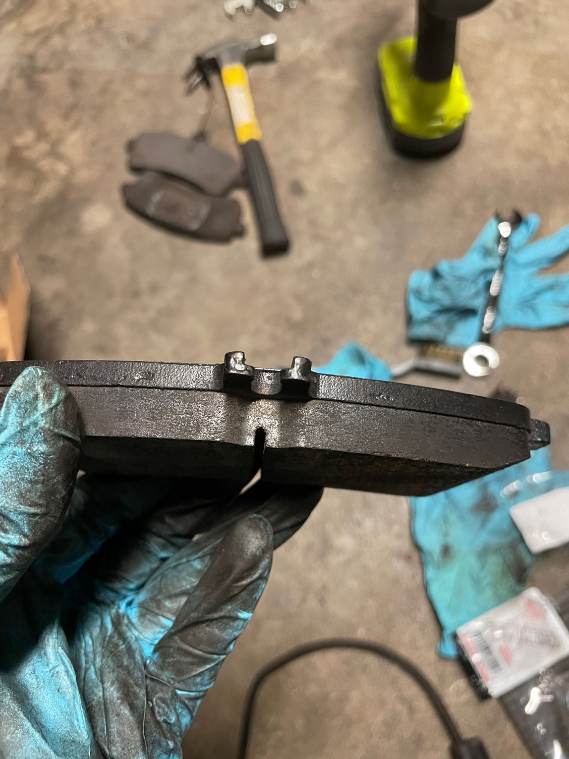

I am in the process of installing Powerstop z23 rear brake pads on my car. However, I noticed that all 4 pads do not have the hole for the brake pad sensor to go in, unlike the original mercedes pads. Am I doing something wrong? Pads are Z23-1669
You're totally fine. There's only 1 front sensor and 1 rear sensor. Funnty thing is I've been working on cars for 40+ years and I have to remind myself of this every time I do a brake job.

What I mean is none of the pads that I got for the rears had the hole for the sensor. Therefore, I can’t install the rear sensors.

If you have CCB's then just a rear sensor, if you have regular AMG brakes then there should be a sensor for front and rear. They must have packed the box incorrectly, forgot to include a pad with the notch for the sensor.

So I reordered them and this time it came with the hole for the sensor. I guess the previous one I got was defective and they forgot to drill a hole for the sensor. The previous one has a manufacturing date of 2020, and the newer ones I got are from 2024.
