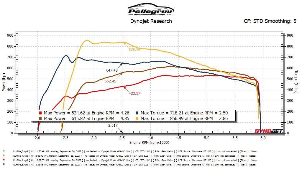

S63 Dyno day
2015 S63 AMG 4matic coupe.
BMC air filters, air box risers, cats removed, Renntech diverter valve, -20deg washer fluid injection
Eurocharged E47 tune.
The dyno graph shows the first and last run of the day. I had a total of 4 runs all with the E47 tune, adjustments being made remotely by Eurocharged.
Any comments?

Wish I had a variety of all-wheel drive facilities to go to, so we could somewhat compare. I am currently at a stage one, Eurocharged pump gas tune, RENNTech diverter valve, Black boost cold air intake, Eurocharged TCM stage one tune. The rest of the RENNTech parts were shipped Monday and should be arriving Thursday. I will try and get them installed Saturday. Those parts will put me at a stage two. RENNTech downpipes/high flow cats, RENNTech sport mufflers, RENNTech intercooler upgrade kit with pump, Eurocharged pump gas stage two tune (which I already have downloaded in the handheld unit). My vehicle is a 2016 Mercedes S63 4matic sedan. I hope all is great with your vehicle and have a fantastic time cruising around in your beast.
