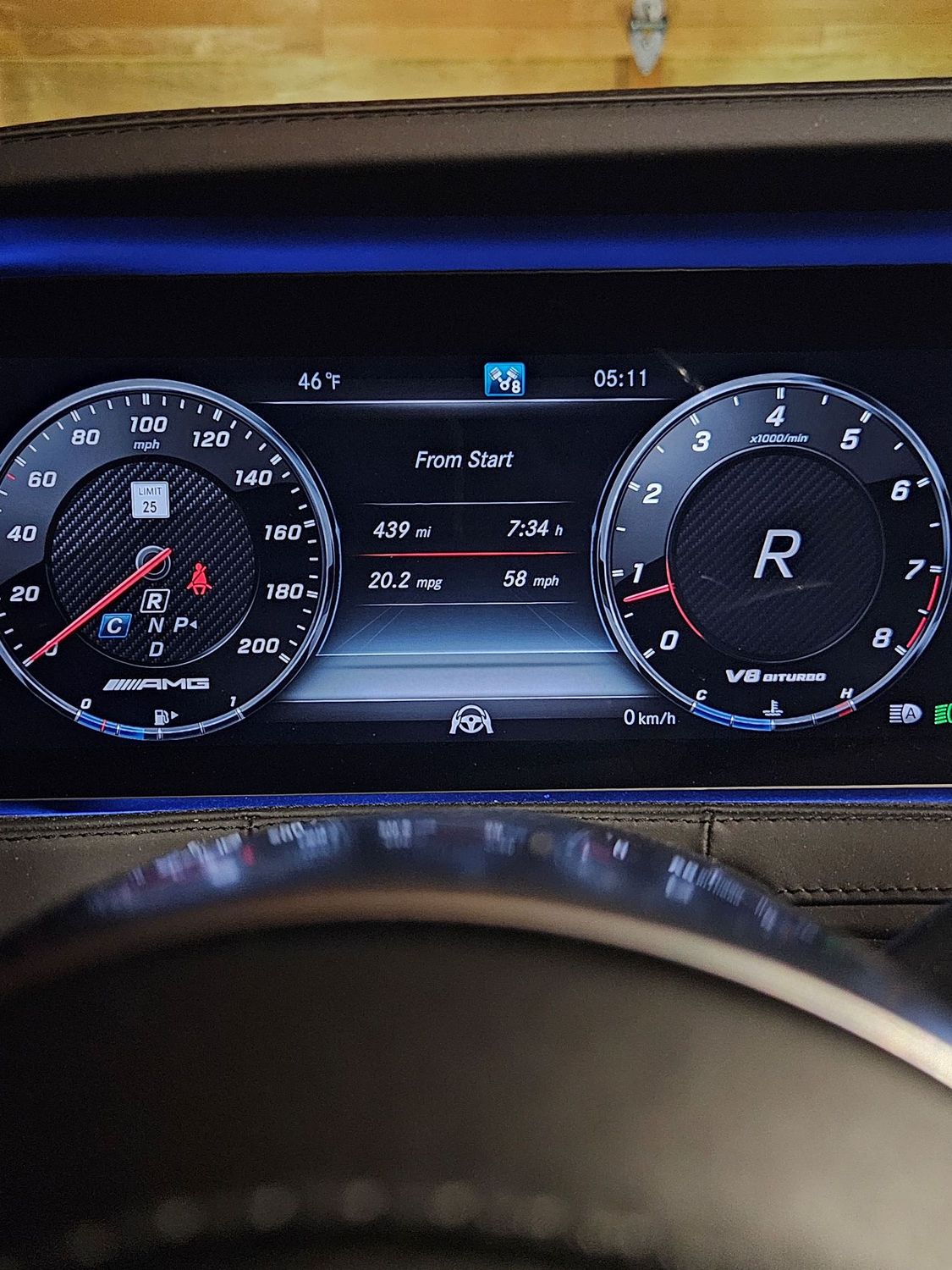

I just took a long-ish one day raod trip to visit a family member. I was curious to see what my car's real highway mileage would be. The trip was around 440 total miles with around 380 miles on the highway. It also includes leaving the car turned on while picking up my elderly momand loading her walker into the car. Her presence also meant I couldn't go as fast as I wanted...I'm sure you guys know what I mean...LOL. It was also raining heavily for the first 180+ miles from 7AM to 10AM, then light rain afterwards. 20.2mpg is slightly lower than expected.

That is lower than I'd thought, especially at average of 58 mph. I wonder if weight and 4 matic makes that big of a difference. My GTS used to get 23-24 crusing at 70+ mph.

Something is off forsure.
Proper tire pressure
clean air filters
spark plugs

Thanks for the feedback. I'm running 49psi on all 4 tires. I'm at 47K miles so I'll do the air filter within a couple weeks. I was hoping to wait until summer before changing spark plugs. Air filters were changed at 37K miles in the summer of 2023 so they're less than 18 months and 10K miles. We'll see if the air filters make any difference.

That indeed seems kinda low. Vehicle weight doesn't play much of a role anymore at highway speed as air resistance becomes the dominant factor. The S63's rated highway mpg is 26 mpg, same as my C63 and on long highway trips like that I've seen an average as high as 24 mpg with DISTRONIC set to 75 mph and just cruising along. Varies somewhat depending on head vs. tailwind and elevation changes, and rain does lower mpg due to the higher rolling resistance as the tires have to displace the water on the road and it cools the tires so they are not necessarily at optimal temperature. Also, the winter fuel blends yield lower mpg. DISTRONIC disables Glide mode, not that I'm ever using Glide mode, but it's worth mentioning. Also, the S63 has cylinder deactivation, which my C63 doesn't have, but from what I'm reading it doesn't switch to 4-cylinder mode when DISTRONIC is active. Did you cruise along with DISTRONIC mostly and have you noticed if it ever went to 4-cylinder mode?

Thanks @superswiss !! It rained most all the way down there, and 50%+ on the drive back and I generally don't use cruise control in the rain. I used distronic for less than 50 miles of the entire trip. However, it never went into 4 cylinder mode as far as I remember. I've seen it go into 4 cylinder mode around town, even in the few days since my road trip. And I only had a couple occasions where it went into Gliding Mode, mainly on short downhill sections, which were immedeately followed by an uphill section. Any effect of coasting downhill was erased by an uphill section. My normal mpg from mixed use is around 14mpg, which is also kind of low. It might be due to how I drive the car. Maybe it's best if I reduce the frequency of fast starts.
