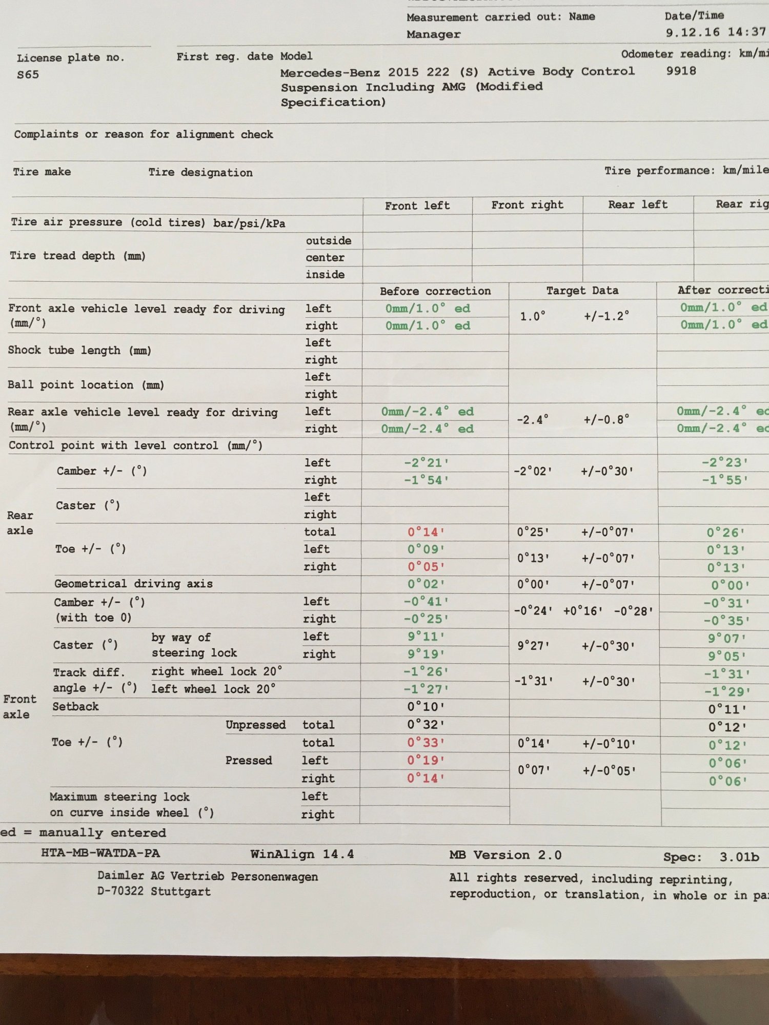

What is the correct camber-angle on the rear axle?
V222 S65 2015
Old Feb 1, 2025 | 03:41 PM
Quadrobenz's Avatar
Joined: May 2009
Posts: 810
Likes: 182
From: Laguna Niguel
'94 SL600,'05 SL600,'06 S65,'07 E63,'14 E63S,'09SL600 all sold, ‘15 S65,‘18 E63S,'17 SL65, '17S65Cab
Here is a complete Alignment data sheet for my W222 S65. You want the numbers in the Target Data column.

Perfekt! Thanks
