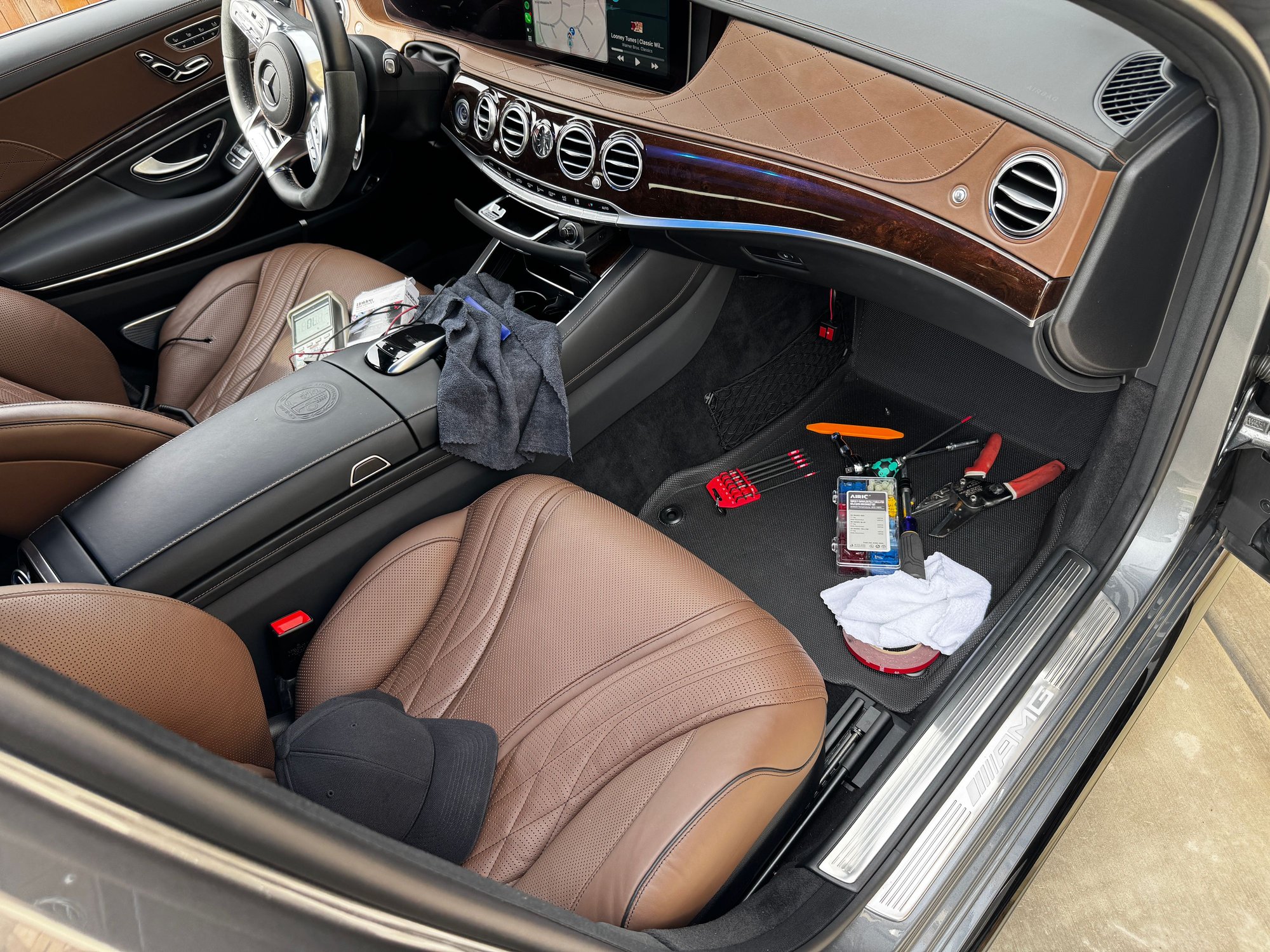

Got the Uniden hardwire kit installed using the ash tray 12v outlet. All told it wasn't overly difficult to do. You just need to remove three torx screws from the passenger side under-dash cover, a 10mm nut behind the AIR BAG cover on the A-pillar cover, pull back the body door seal, and remove the two torx scews holding the ash tray in. I'd say the hardest part was getting the ash tray plug disconnected/reconnected and reinstalling the torx screws for the under-dash cover. Fishing the wires was easy. I just used a piece of aluminum filler rod for TIG welding that I bent to pull the wires through. I used a couple of wire taps (I know, I know) on the ash tray side since it was a bit easier to access the harness there. Black is positive, and brown is ground if I remember right. I bundled the extra wire under the dash and zip tied it, and mounted the Uniden controller on the under-dash cover. I never intend to use the mute button on the hardwire kit, but I needed to put it somewhere. Works great now and no more dangling wire.

Great job : )
