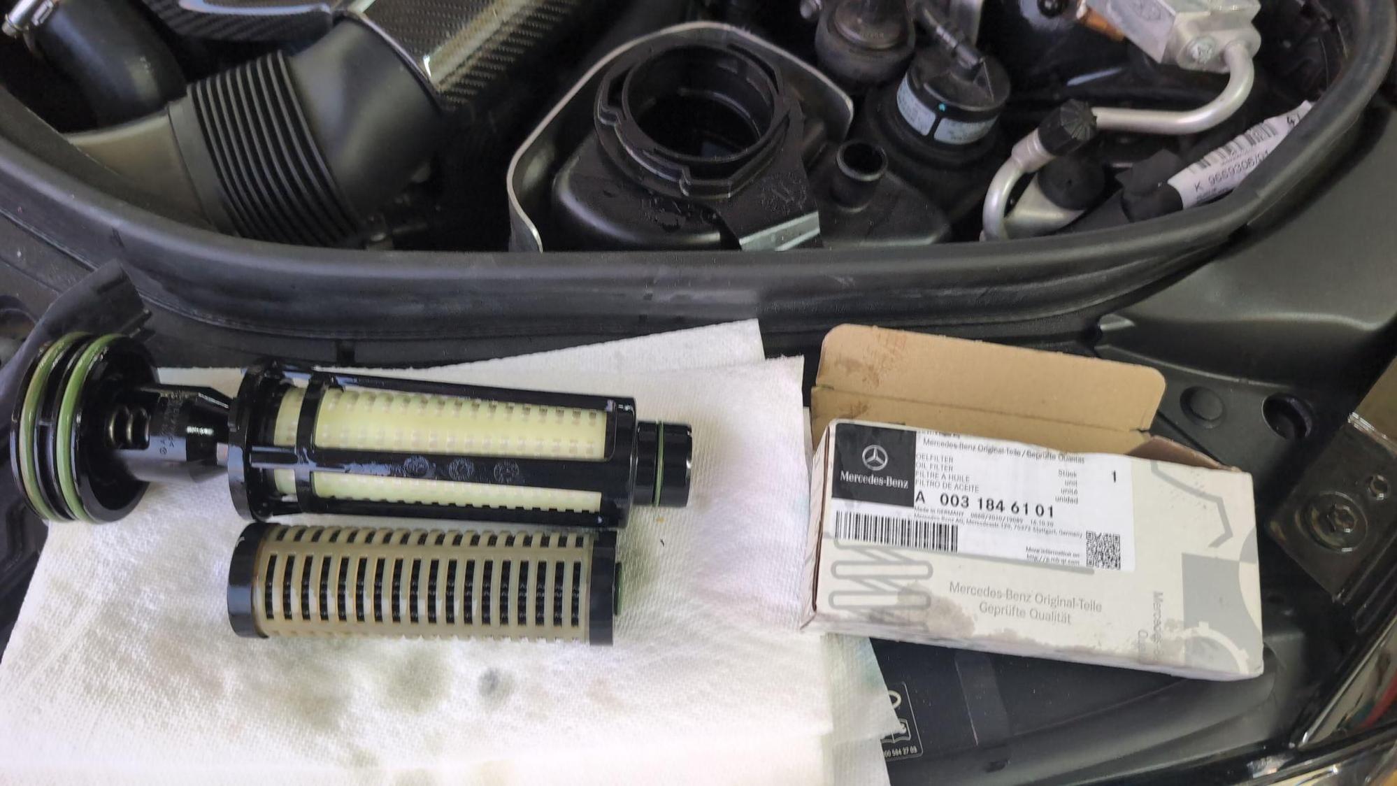

ABC Flush
15K mile ABC flush.
Sucked as much of the old oil out with a vacuum canister, added fresh oil, AGA tool (love that thing), and started the engine.
Fluid was sill sort of greenish, but the filter was pretty dark. Ran the fluid through a 1 micron sock before it dumped into the trash bucket (just wanted to see if it would catch anything, but didn't catch much).
Before someone with a keen eye mentions it, yes, I did get the O-ring at the bottom of the old filter and reinstalled it onto the new filter.

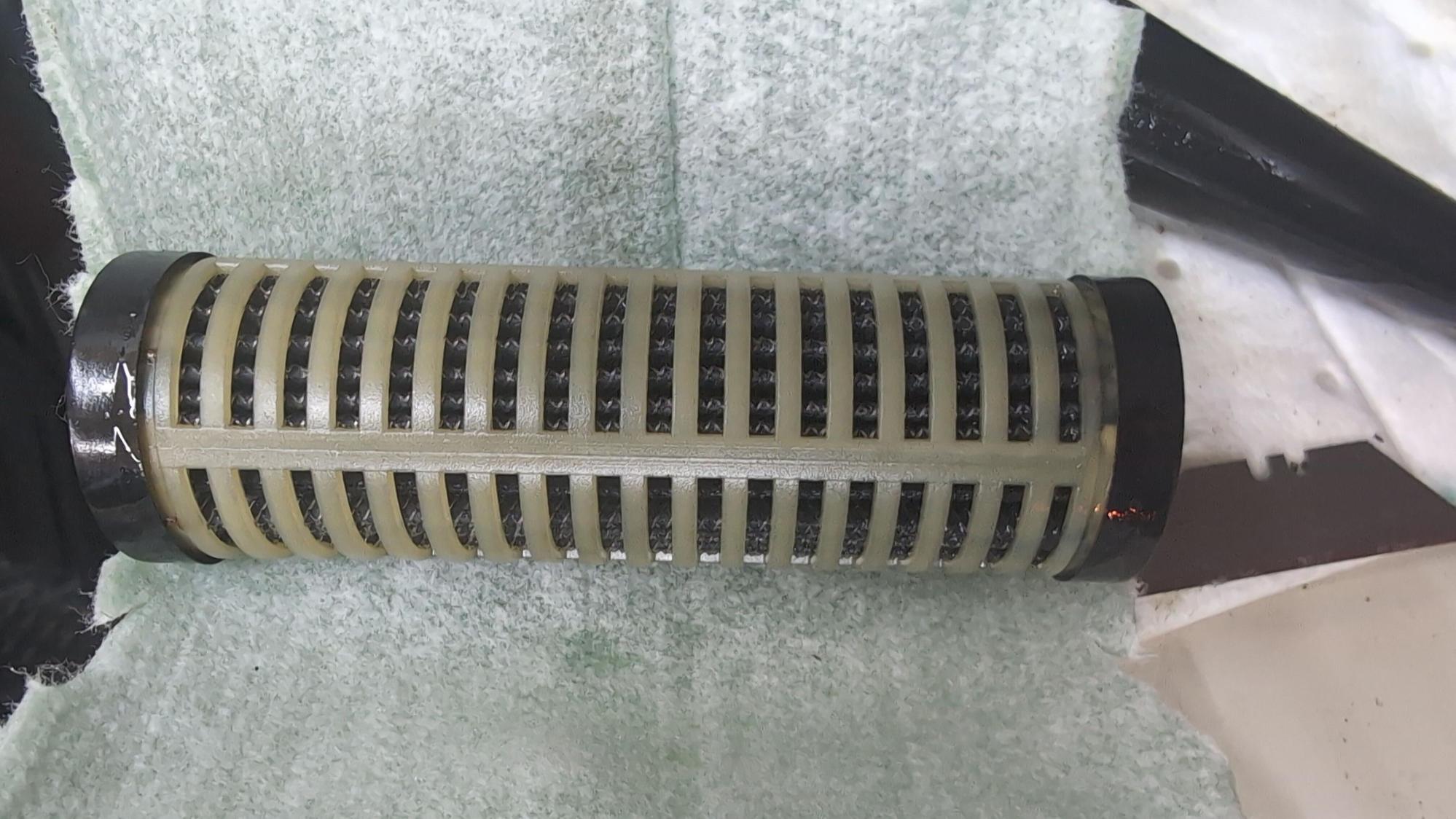

New filter picture after two rodeos and about 150 miles of driving.
Used about 12 liters in total, but I flushed it longer than strictly necessary.
