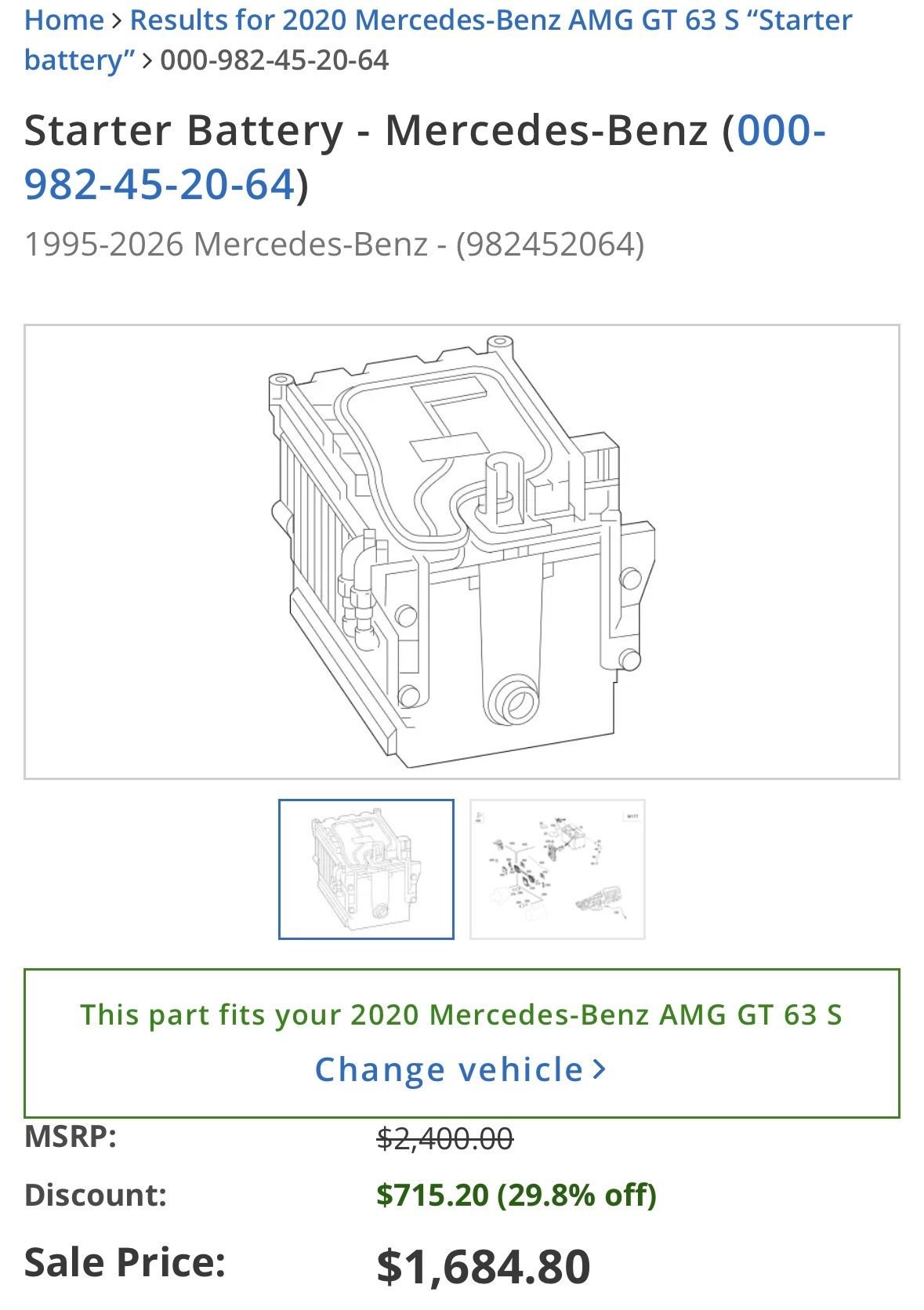

Hello I have a 2020 63s 4d sedan and I’ve been having an issue over the past year where sometimes my car won’t start not even with a jump but if I walk away and come back 10 minutes later it starts up no problem and I’ve taken it in multiple times so far and this past time they’re telling me I need a new battery which is $3200. Has anyone else had this issues as well?
On a side note they’re also telling me I have 2 batteries and main starter one is on the trunk and I’ve checked and there’s an air compressor in the trunk and no battery, just the one under the hood so am I missing anything?

The GT63s has this lithium-ion battery which they tell me needs to be programmed after being installed and they’re telling me the auxiliary battery is an H9 AGM battery but who knows. The battery under the hood says on it LIT-ION so I’m assuming that’s the main starter battery. The issue I’m having doesn’t make sense that it’s the battery bc if it’s a dead battery then the car shouldn’t start unless it gets a jump but with me it starts up when it’s not connected to a jump box

Ah ok, the GT 4-door does have a lithium battery. So yeah those are pricier. When the battery gets faulty, you can have all kinds of weird issues that may not make sense.

Here are aux battery options. Less than $300 for the battery, but it's an aftermarket battery. You'll be at $2000 in parts, so $1200 for labor is still insane.
https://www.fcpeuro.com/Mercedes~Ben...atic&year=2020

Definitely Crazy!!
The OEM auxiliary battery is under $300. The $3,200 quote from Mercedes is just for the main Lithium battery ($2400) and $600 in labor and then CA tax which comes out to 200 and change. I’m not disputing that the battery has to be changed at some point but this problem I’ve been having over the past year doesn’t seem to me to be a battery related issue if every 2 months or so the car won’t start but if I walk away and then come back 10 minutes later it starts up with no issue
