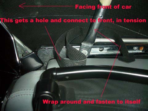

I recently had a soft top installed on my '93. On each side behind the door glass there is a loop of stretchy material that looks like it should have been in the top's fabric somehow. Can anyone tell me what this is and if it is important to the top's operation?

pictures of strap
These do not show it very well but it is the best I could do.
Attached Thumbnails Soft Top Problem, HELP!-imgp1552.jpg   Soft Top Problem, HELP!-imgp1553.jpg

Look at this video. It clearly shows what to do, It needs to be fastened to the post , by first making a punched hole and then using a screw to tie it down t othe post. It is elastic and will provide some tension to keep the part of the soft top taught.

Check the video for the front elastic, which shows that it is a single strap, not a loop. The second strap in rear wraps around itself onto the upright post and has a slit whoch you insert and twist into itelf as the method to fasten. some have velcro instead.
see below picture

I do not have the attachment for the strap it shows in the video so I attached it to the 2 screws that hold the side of the top.
It seems to work properly.
