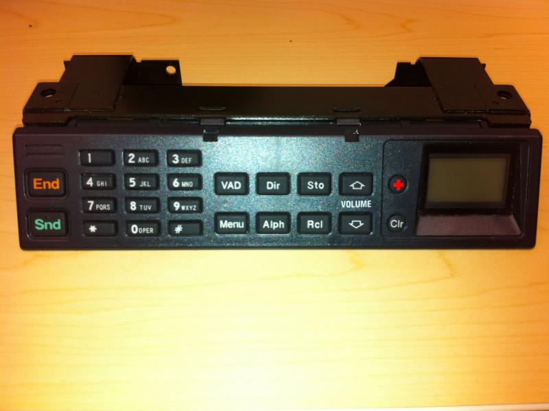

I found this in the trunk of my R129 when I purchased it. It would appear to me to be the factory phone and my best guess is that it belongs where the sunglass compartment is. Can anyone give me any information on this and if were to be worth hooking up at all? (see pic)

You are correct, it's the dial pad for the phone and it fits in the eyeglass
compartment. Unfortunately it's analog without GPS so the cellular providers
won't hook you up. ( I know as tried a few years ago). I removed mine and hope to figure a way to fabricate a slide out GPS and XM radio for this compartment.

the phone is not up to standards. I, too am interested in a meaning full adaption of the slot, as well as the center console ash tray and cassette holder. Anyone try the pop up radio system?? Cup holder??
