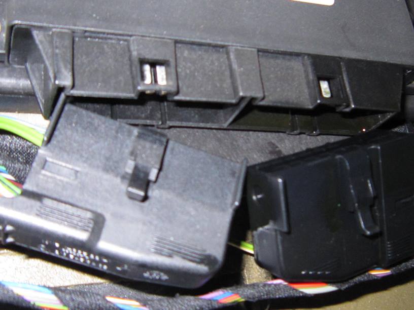

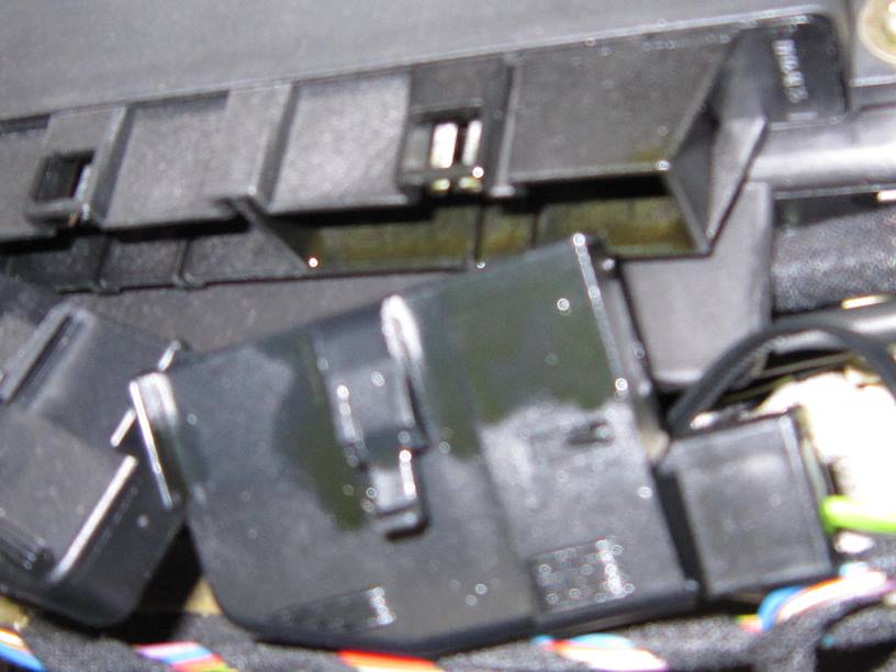

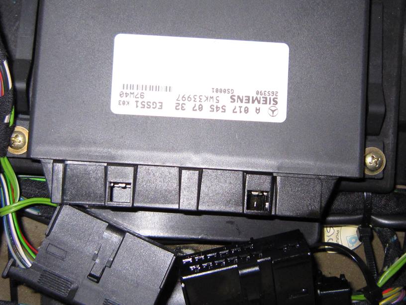

Here are pictures: Transmission fluid squeezing electrical harness into transmission control unit?-lzzxfjn.jpgTransmission fluid squeezing electrical harness into transmission control unit?-ydivqvg.jpgTransmission fluid squeezing electrical harness into transmission control unit?-ag8ftuk.jpg

The problem that you are experiencing is common to the 722.6 5 speed transmission. If you do a forum Search you will find that the culprit is a $15.00 A/T Plug Adapter p/n 2035400253 that has multiple O-rings that may have failed to do there designed job. MB has redesigned this part several times. Please read http://www.benzworld.org/forums/5715642-post3.html
