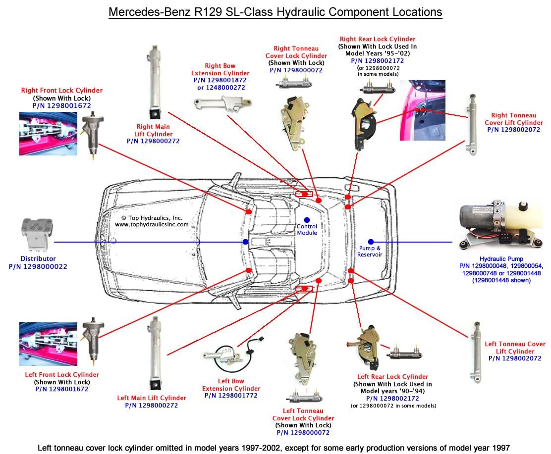

there are many ways in which a bad RST controller can exhibit problems. A bad controller will normally give a matching error code if checked through Star Diagnostic (SDS).
In your SL, there are two instances in which the top can show brief delays during movement without it being a fault at all. The first time would be when the top is at its highest point, and the second time would be when approaching the windshield header or locking thereto.
The explanation for the first speed bump at the highest spot is going to "differential operation". That is applying pressure to both sides of the main lift cylinders A129 800 02 72, which yields a slower effective cross section for the hydraulic pressure to move the piston upward, and thus results in the top moving slower. It is designed to keep the top from hitting the windshield too fast.
The explanation for the second speed bump is the magnetic sensor in the middle of the windshield recognizing the magnet in the front of the soft top and getting ready to latch with the top lock cylinders A129 800 16 72.
I know you had the front /top lock cylinder 1298001672 rebuilt/upgraded. Has the behavior of the top changed a lot after that, or may you just be more perceptive to the top movement's intricacies after dealing with the hydraulic system a little?
Klaus
www.tophydraulicsinc.com
R129 SL-Class roadster top hydraulic component locations
