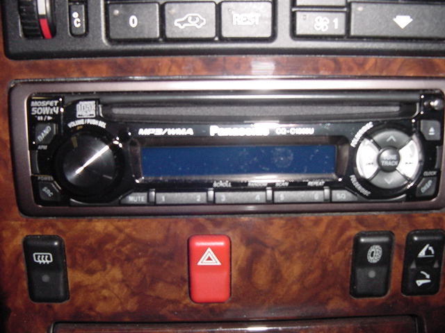

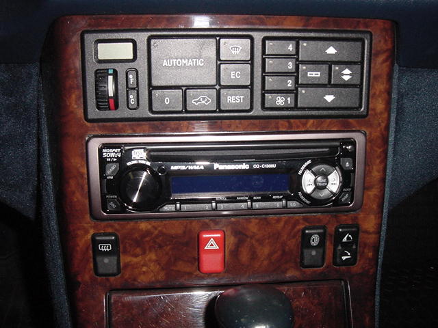

In a previous reply, I said that I had sent a Email to Tom, realizing that the post was quite old. I suggested that another option might be considered to the 6/10 trunk mounted CD changer, and others might be interested. I just installed in my (wife) 1992 500SL, a Panasonic CQ-C1300U CD player. This model plays Mp3 and WMA compressed CD's. I have burnt 10-12 WMA CD's, each containing 8-12 complete CD's (8-14 hours each). I removed all that Becker stuff; radio/tape head, in trunk tunner/amp, in trunk 10 CD changer, etc. The installation was simple, with only the antenna wire needed to be routed to the front using an extension.

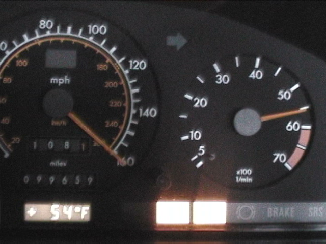

Picture of (maybe).

Well it worked uploading a picture; as promised, a picture of the dash with the Panasonic CD/MP3/WMA, AM/FM radio head installed:
Attached Thumbnails 300 SL 1991 CD player-dsc00002.jpg   300 SL 1991 CD player-dsc00003.jpg

Originally Posted by RUCKDR
Picture of (maybe).
Love how you drive your car.........at 160+mph.......

SL BRABUS,
Don't I wish. That was on the Dyno, I made a high speed run and took a video as we did the Dyno. The car actually pulled 275.6 Rear Wheel HP and 298.8 Real Wheel Torque. Conservative conversions to engine HP/Torque by the Dyno shop says 344.5 HP / 373.5 Torque, not bad for a '92 with nearly 100,000 miles at that time. ; and it ran to the 160 MPH mark without any hesitation, smoooooooth.
