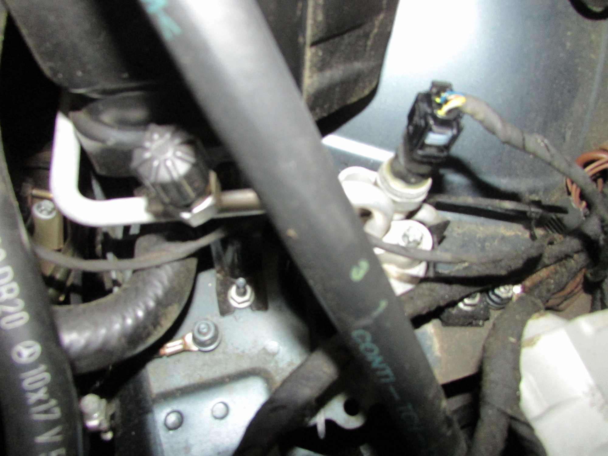

I just ordered the “For 2003-2006 Mercedes SL500 A/C Refrigerant Temperature Sensor 74425WH 2004 2005
Seller: autopartsgeek
[img]file:///C:/Users/HEARIN~1/AppData/Local/Temp/msoclip1/01/clip_image001.jpg[/img]
https://www.ebay.com/itm/For-2003-20...8AAOSwb91dZn6n
It goes above the dryer. Do you just unscrew old sensor above the dryer, and screw in new sensor with minimal refrigerant loss? If not how do I replace it?

Here are the DTCs. Is sensor 1 the previously purchased For 2003-2006 Mercedes SL500 A/C Refrigerant Temperature Sensor 74425WH? If so, can I just unscrew the old one, and screw in the new one? Or will unscrewing the old one purge all of the refrigerant?

Is this refrigerant sensor1? If so, how do I replace it? Can I just unscrew the old one, and screw in the new one? Or will unscrewing the old one purge all of the refrigerant?
