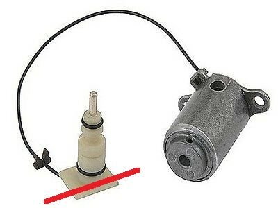

The M120 is a piece of cake against the M275, I own both. Sometimes you need a little extra time to do something, but there is nothing to be afraid of. The ADS 2 is not complicated, nothing compares to the ABC.
The only mysterious thing for me is the seal from the oil level sensor. @crconsulting how do you get space to pull the sensor out of the hole?

@ AndreasHannover. It doesn’t pull, it pushes.
There’s a clip on the outside. It sits in a counter bore on the outside of the block. There’s also a slot machined into the counter bore so you can push the clip upwards thru that "gate", and release it. You will have to push the clip upwards with a screwdriver or something long. (working from bottom)
Once you have the pan dropped, the sensor comes out from the INSIDE. It has two bolts that I red loctited into place. It helps to slightly lube the O-ring to push the sensor in place. The square end of the sensor seats in place inside the block. Pay close attention to how the wire is routed, and orientation. There is a plastic clip suspending the wire, be gentle pushing the new one back in place. Once it’s seated properly, you push the clip back on, though the “slotted gate”, and rotate it back into place.
Hope that helps, it’s actually not that hard of a job.

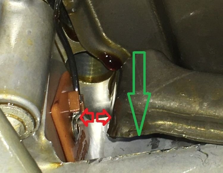

My fault, i should ask more precise. There is a thread here with a picture inside the engine: https://mbworld.org/forums/sl-class-...er-sensor.html
Some people and i can not pull the sensor inside because of a support blocking the sensor. How do you manage this? Any hints would be very welcome.

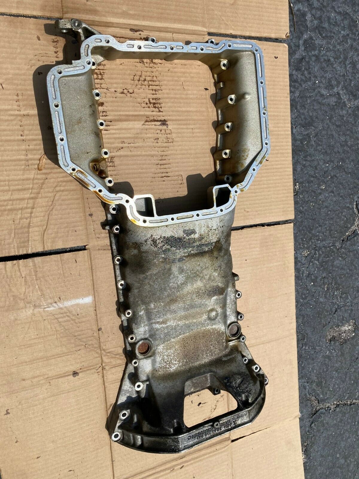

Here's the pic I took before I changed out the sensor. (very clean for close to 100k)
Take a look at my rear baffle, its a little out of focus, but you can still see it.
Maybe they changed it starting 98? Lower casting appears different too.

My independent tech says there is a special MB tool that he uses to fish the old sensor out and put the new one in.
The oil level sensor is the leakiest part of the engine. I'm on my 3rd one and they never really seem to seal properly. I even got a new outer clip because the original one was a little misshapened over the years.

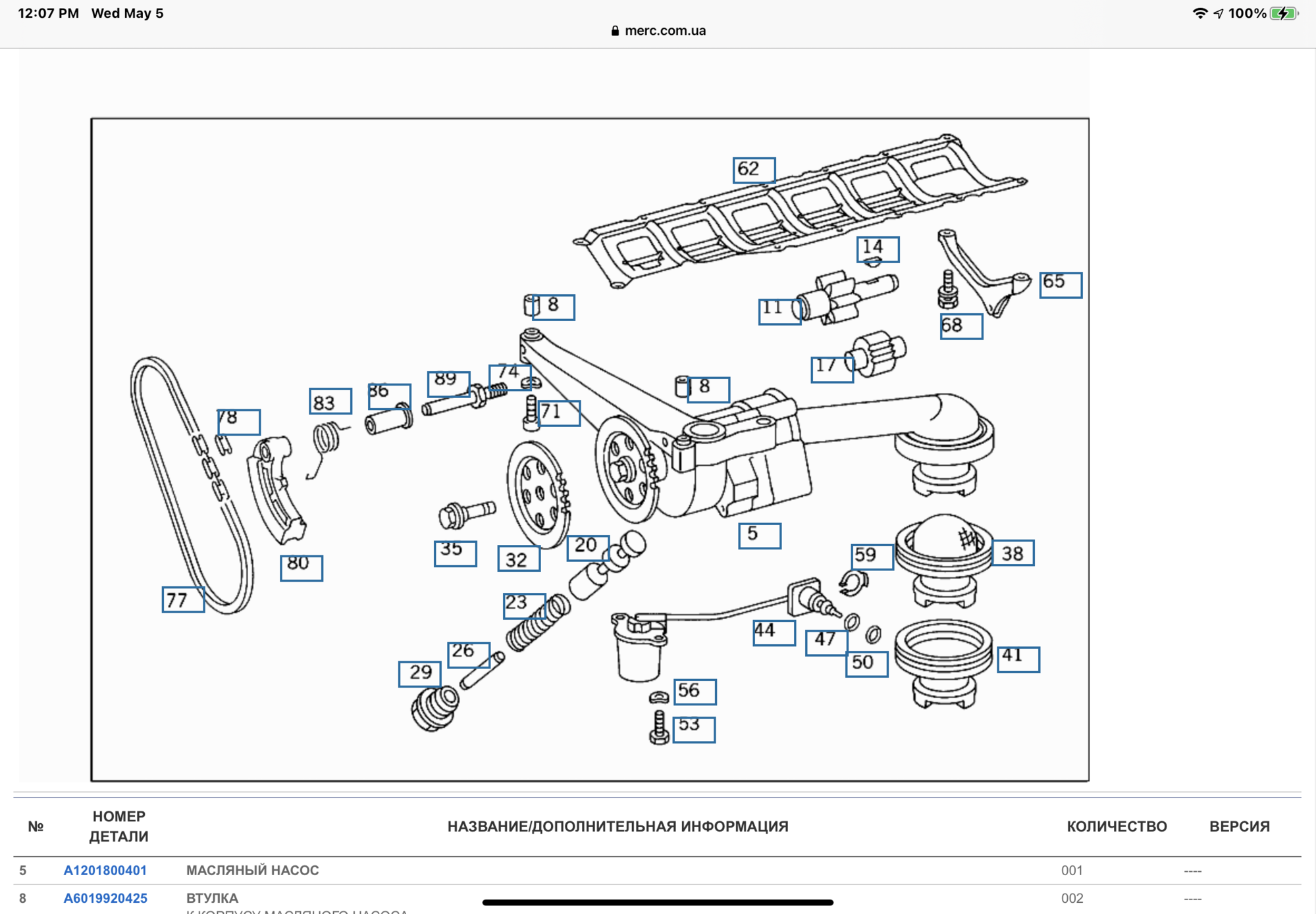

It looks like that part (65) unbolts no? Unfortunately mines buttoned up or I’d have a look, but I thought I saw some bolts back there.
At least on the ‘97 version of the engine I have. Your casting is definitely different too. Have a look at the illustration below.
65 A1201860195 REINFORCEMENT 001

We have two SL600, both year 97. The picture of me was borrowed from the other post.There must be a little secret how to reach the bolts, for me, there is no way to reach them. But your picture shows me, it must be possible. You unbold the oil pan, unbold nothing else only pull it out, magic.

On mine I didn’t even unbolt anything! As you can plainly see from my pic, it has plenty of clearance just to remove the sensor without unbolting anything else.
One would expect revisions from factory to IMPROVE the design not make it worse 😕
Just FYI my car was built 10/30/96. When were yours built?
also I worked on a 96 several years ago, doing the same job, and don’t remember having any issues removing the sensor.
I thought you might be able to access the reinforcement plate/rear baffle bolts thru the squarish casting part on the back of the oil pan, but looks like that piece is solid, WTF? You can see from my pic those bolts are right on top of that piece/shelf
Wonder if they forgot to put a hole in that casting??? Doesn’t seem to do anything....
LOL!! 😀 I think the “factory special tool” is a 1” drill bit....

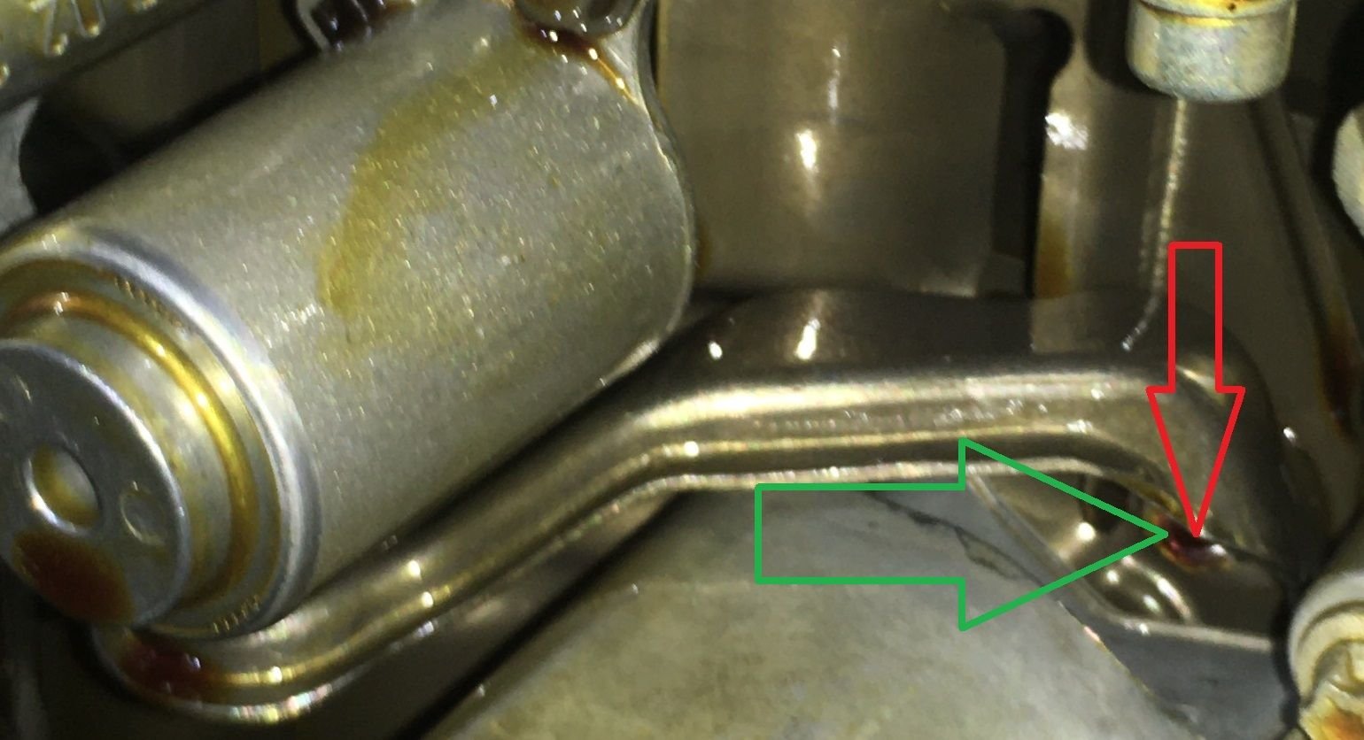

I am afraid that i found the solution, it is a failure by design. This can not work, one screw is behind the scenes, follow the green arrow:
more close
moooore close
And then, an other supplier made an offer, Mercedes could not resist: We make it cheaper.
F**k

That is crazy! So we're seeing NEWER M120's revision are the ones that seem to be a problem? late 97-up? (my car was mfg'rd 10/30/1996) It also seems like the upper oil pan casting is different too.
Honestly, don't know how you're going to get at that. That is a huge f**king fail.
