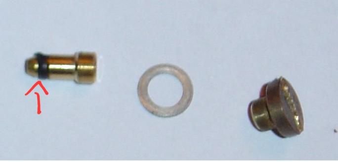

we finally located the problem. It was the EHA valve o ring! Changed it..car starts and drives perfectly.

Not your typical failure mode I must say. Normally they start leaking to the outside before the o-ring(s) go. Although I have never opened the adjustment mechanism like that.
I assume you put it back together exactly how it came out? Or maybe you readjusted it? Would it not leak fuel if the o-ring was bad? Just asking questions as I do not have the answers.

dolucasi.. certainly not the typical failure...i put it back exactly how it came out.
there were no leaks, two cylinders were not getting fuel the way they should one was
getting too little and one too much. it did smell rich.
the question is, will this be the end of the random engine shut down or it only solved the "no start" issue... I guess time will tell..

I suspect this is not related to your random shutdown or your uneven fuel distribution. I assume you verified that the uneven-ness is gone now.
Hopefully the car was not run like that for long as that will ruin piston rings because the super rich cylinders get washed out and starved for much needed lubrication of the oil.
You probably have underlying FD issues too and should make sure the fueling is good and even under all engine driving conditions.
I would first check the Duty cycle at idle versus 2500rpm and make sure it does not vary too much (less than 10%).
And remember that the EHA current actually varies even more under load conditions in which case there is more demand for fuel if there is a fuel delivery issue from the injectors.
But again the cause of the random shutdown I suspect is something different.
