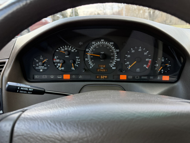

Hi folks. Question for ya…. Obviously there is a CAN bus / electrical / data issue occurring here. Suddenly, and unpredictably, my 1997 SL500 will throw a CEL (P1747), lose several gauges, and show an ASR and Oil warning light.
Obviously this is a wiring issue of some kind, not a mechanical one. The question is: what is supplying this data to the cluster and the gearbox simultaneously?
Any help appreciated!
Lucas.
