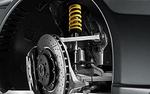

Like the SL65 Black? No ABC. Best Nürburgring times.
Attached Thumbnails Replace ABC with "standard" shocks?-screen-shot-2010-05-25-9.17.10-am.jpg
And your friend is Mario Andretti? The Stig, perhaps? Of course, it's up to him and what he considers an acceptable balance between ride quality and handling.
Furthermore, you're comparing an R230 to an SL65? Apples to oranges.

I just thought it was a bit low to suggest that an SL500 would ever handle like a Chevy. Doing some more research, however, I imagine that the car wont have clearance for things like roll bars that it would need to make up for the lack of computer-controlled damping.
