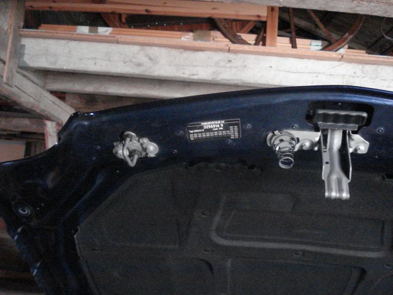

How to check out options on a sl
Hi, you can open the hood and see underneath a sticker that says which codes the car was delivered with.
It's quite small 8 by 4 centimeter, so it's difficult to check out unless you do it yourself or get pictures of it.
Here's a picture:
https://mbworld.org/forums/attachmen...1&d=1343740972
Then you must know what the codes stand for.
Examples from my car:
220 Parktronic front and back
260 elimination of type sign on trunk lid
352 operation and monitoring system (OMS)
401 Comfortseats with cooling and heating
500 Electric adjustable mirrir with memory
614 Bi Xenon
682 fire extinguisher
790 AMG complete wheels
803 change of model year
810 sound package bose
819 CD changer - in trunk
852 Mobil telefon klargjort
882 interior motion sensor
889 Keyless go
985 coc paper and registration certificate
Y83 designo alcantara roofliner anthracite
N53 Don't know
N91 Don't know
N98 Don't know
W72 Designo Labrador Blue Pearl Gnanite
X11 designo natural leather Black
032 designo mystic blue
I remember that only the sl 350 had abc as an option, the rest has it as standard.
Good luck with your search
