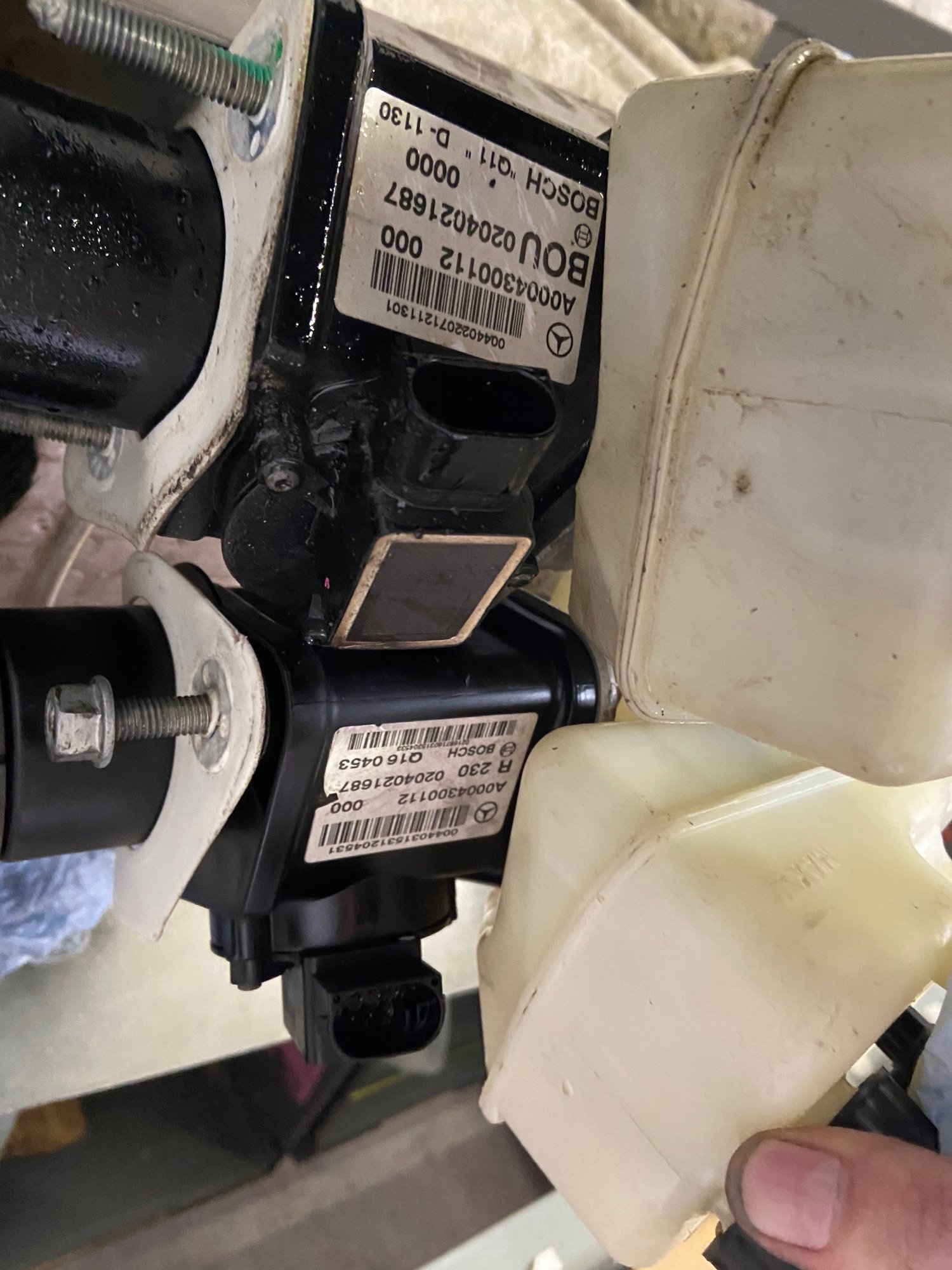

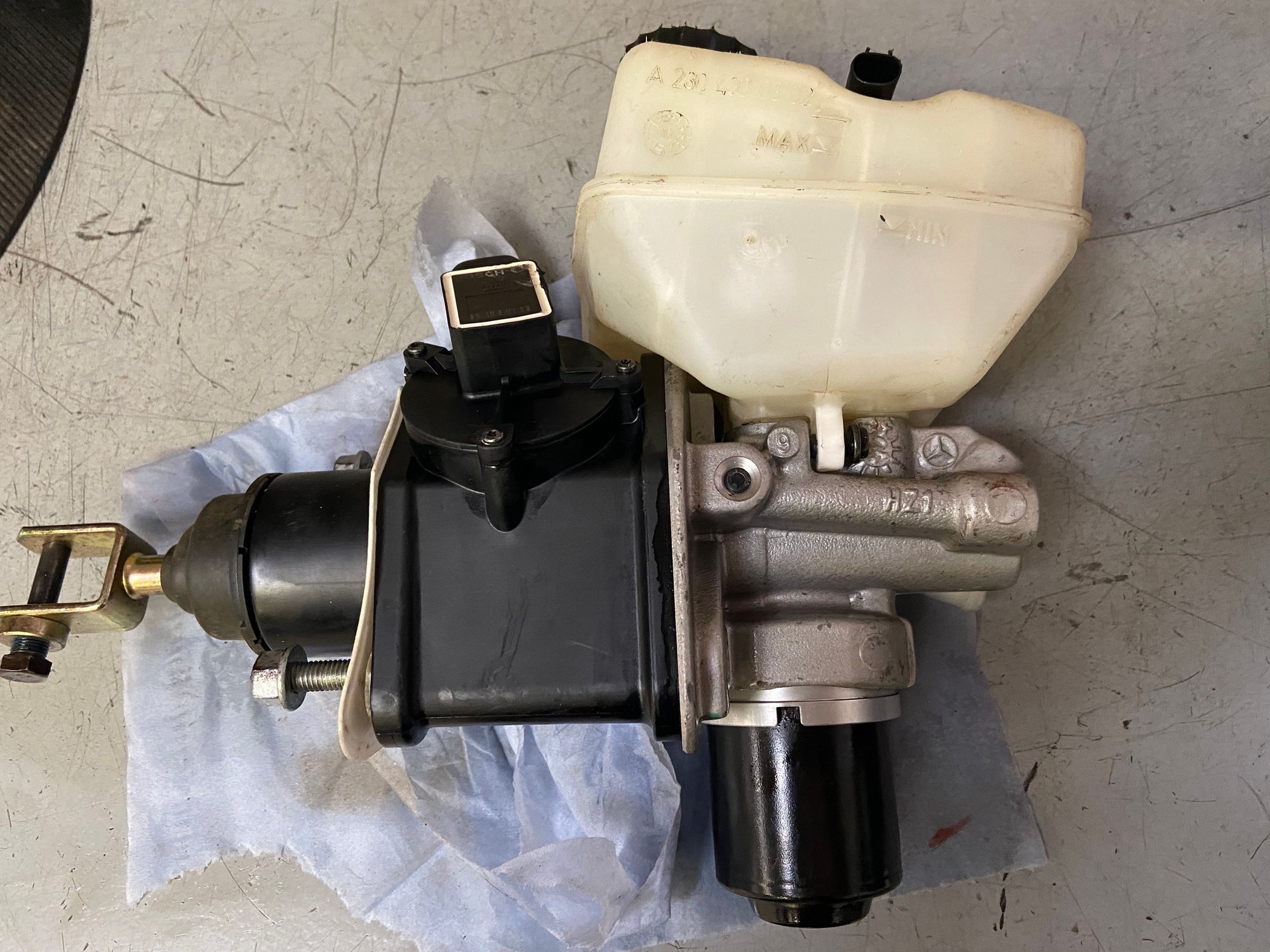

Big Red Brake warnings on Dash is the reason we needed to do this , i assumed Brakes needed bleeding as one of the Brake lines gave up .
The last statement is what i was after , the code points to the master cylinder- we read on the machine that the Travel of the pedal was out of Value , the operator explained that the Master cylinder could be the issue , he had never seen this code or had this problem in over 20 years at MB , my question is to the Forum " is this a common issue " , the hope being that the prolonged period of being laid up prior to my ownership might explain this , have you seen or dealt with this before , does a replacement Master cylinder BOU cure this ?

alright
with these details, yes, you can go for a master cylinder replacement
rare issue indeed
buy a used one from ebay of course
good luck

Another BOU Master Cylinder sourced, bought and fitted ,lets see !

Sorted, £205 inc the master cylinder fixed the problem !
