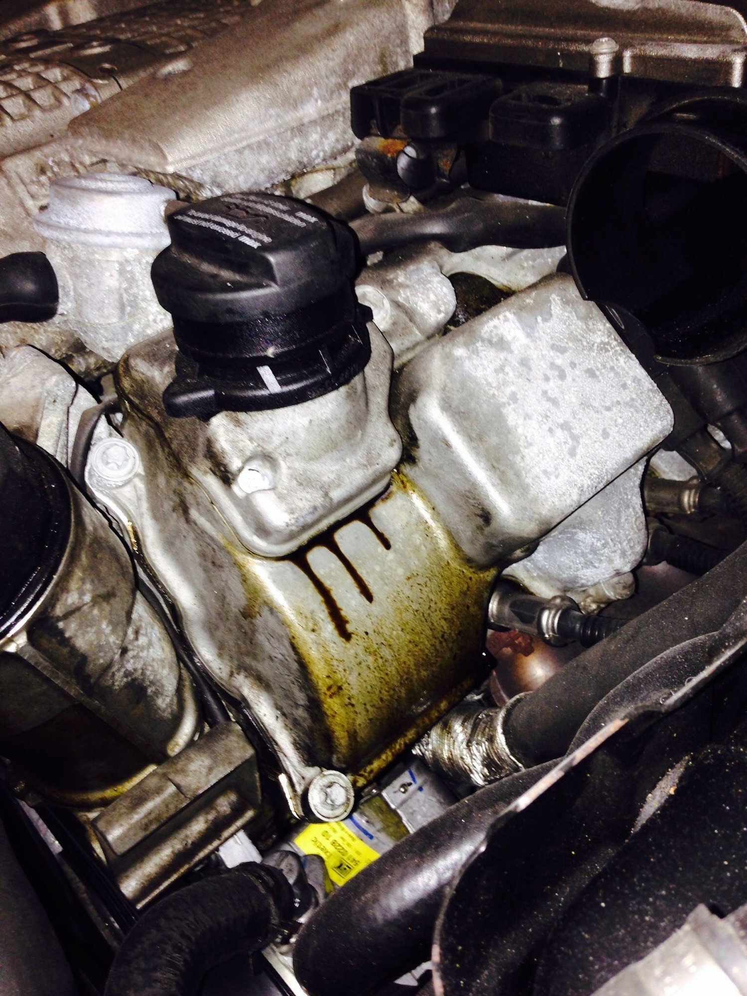

Helpp i have a oil leak and cant find part number
I have an oil leak from the left rocker cover. Its the gasket that sits under the neck of the oil filler cap. Any ideas ??
Thanks in advance

Looks like the upper part of valve cover leaks, need to remove it & reseal it, prefer to use an OEM silicone paste..
http://ozbenz.net/viewtopic.php?f=25&t=20649

Thanks brother zayed! Much appreciated. Seems like a hard job having to remove fuel lines etc?

Yeah, agree with you, needs little bit work, but don't delay, dropping oil will harm many things(Mechanical/Electrical)..!
http://www.benzworld.org/forums/w211...ark-plugs.html
https://mbworld.org/forums/clk-class...ark-plugs.html
https://mbworld.org/forums/w211-amg/...akage-pix.html
