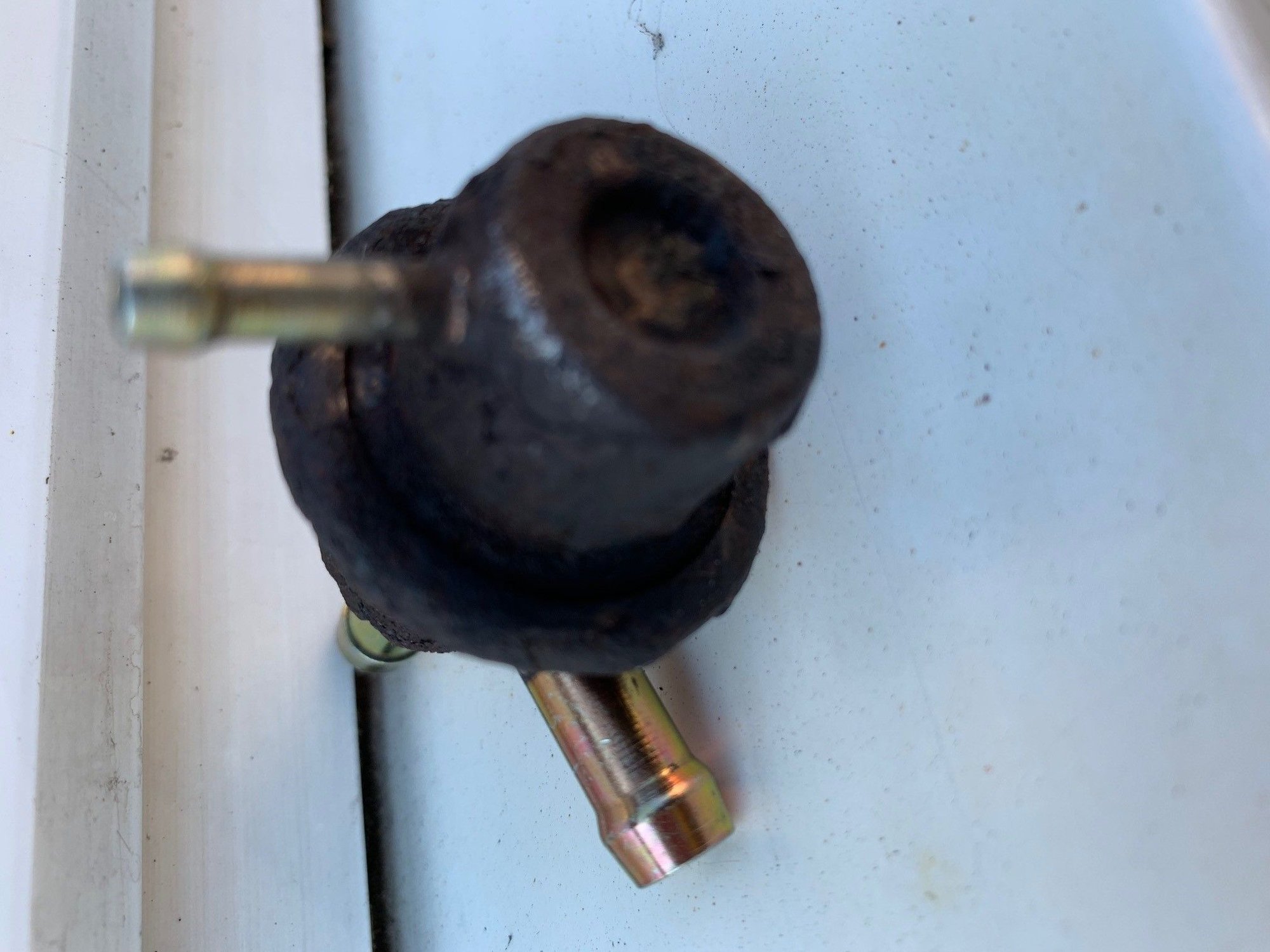

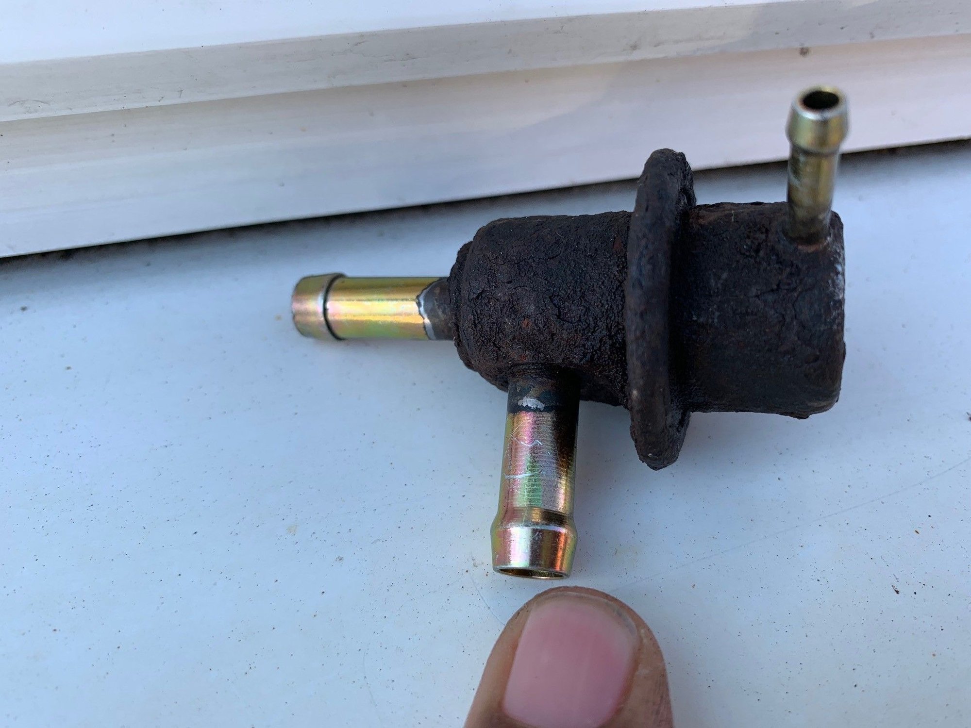

This is the picture of the little quitter that caused all the headaches, it costs around £120 from Mercedes. I have been driving the car all day yesterday, and the problem is solved !
The part is too rusted to get an part number, but I think it may be Valve - Mercedes-Benz (230-476-03-32-64). it is found near the petrol tank, and my Indie had to remove one exhaust back box, then the drive shaft, to get to it.

I have just got the part number from my Indie.
For my car a SL55 AMG KOMPRESSOR, it was 230 476 03 32-64

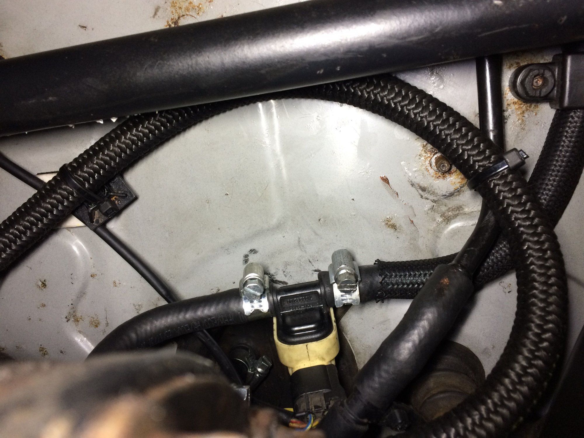

Yeah , had that too ! Worth doing the sensor and any hoses while youre in there !

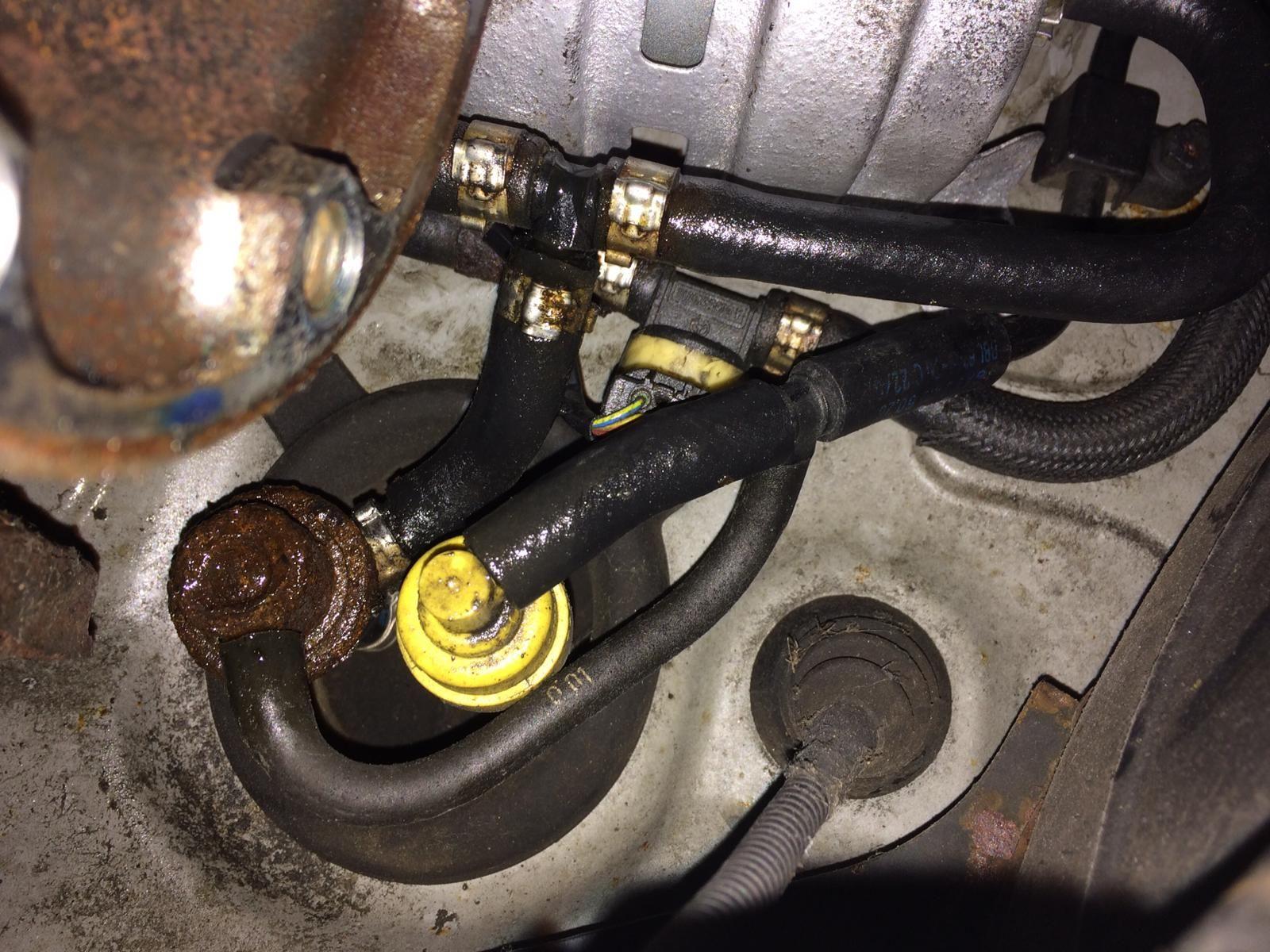

Th Sensor isnt the Fuel pressure regulator ,its a seperate item ( number 20 on the Diagram above ) and shown in my 1st pic in line with the Reg . Its worth replacing as its such a pig of a job to get in there anyway you dont want to do this twice ! This is a better pic , yours wont look like this tho as ive modded the pipework on mine ..

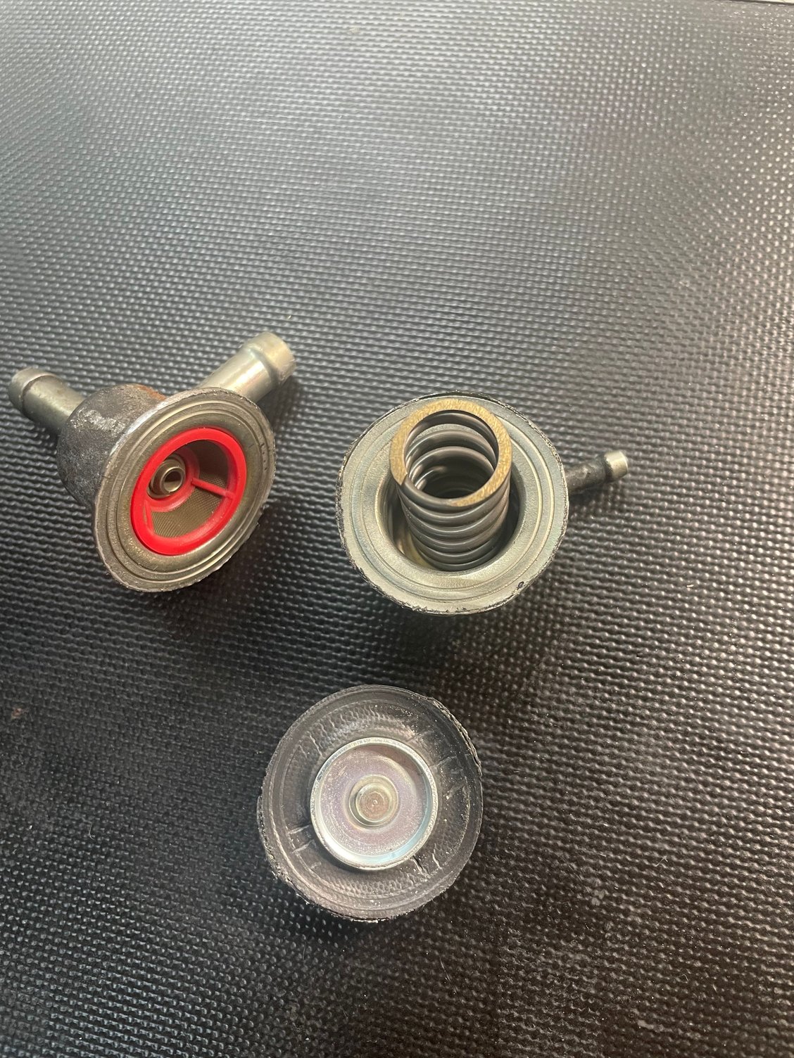

After having the same problems with intermittent stalling and having checked everything, I just bought a new fuel pressure regulator and changed it!
Perfect, since I changed it I haven’t had any problems any more. It was very tricky to do the job. I had to remove the left muffler, no problem at all. I couldn’t take the drive shaft out, so I managed to change the regulator with the driveshaft in place, very, very difficult because you don’t have space non even to have a look at the regulator. People with small hands have a clear advantage.
i want to thank people that post these topics because it makes everything so much easier and by the way, saves you lots of $$$$!
Thank you so much, Ingo
Small cracks in the rubber diaphragm

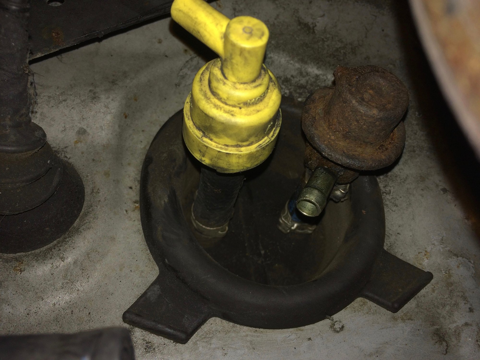

Mine has the bolted axles, but I dropped the entire subframe instead of pulling the axle. I had to do axle seals, strut boots, and the regulator, so it seems liked less work overall to pull it down. Honestly, I don't know how people replace that regulator with everything in place.
I ended up twisting off one of the ABC bleeders and couldn't get the quick coupler on that side to even rotate. That was probably good because it would be stupid to leave 20 year old strut lines in when it is a 10 min. job to replace them at this point. I pulled the rear valve block to bleed the strut line (since the bleeder was frozen), so I will also rebuild the valve block, replace the rear accumulator, and at least put in the rear pressure line and the high pressure feed line from the pulsation dampener. I'm also ordering new fuel lines and, of course, replacing the fuel filter. All of that appears original too, filter included. I will end up spending close to $1k in parts, but this would probably be an $8k dealer job.
I swear that everything under the car is in pristine condition EXCEPT the parts that you need to remove. Not a hint of rust on the underbody, but bleeder screws and couplers are rusted, strut bolts were rusted, fuel regulator is rusted badly. They were about 90% of the way there on corrosion protection, but missed on the stuff that matters.
