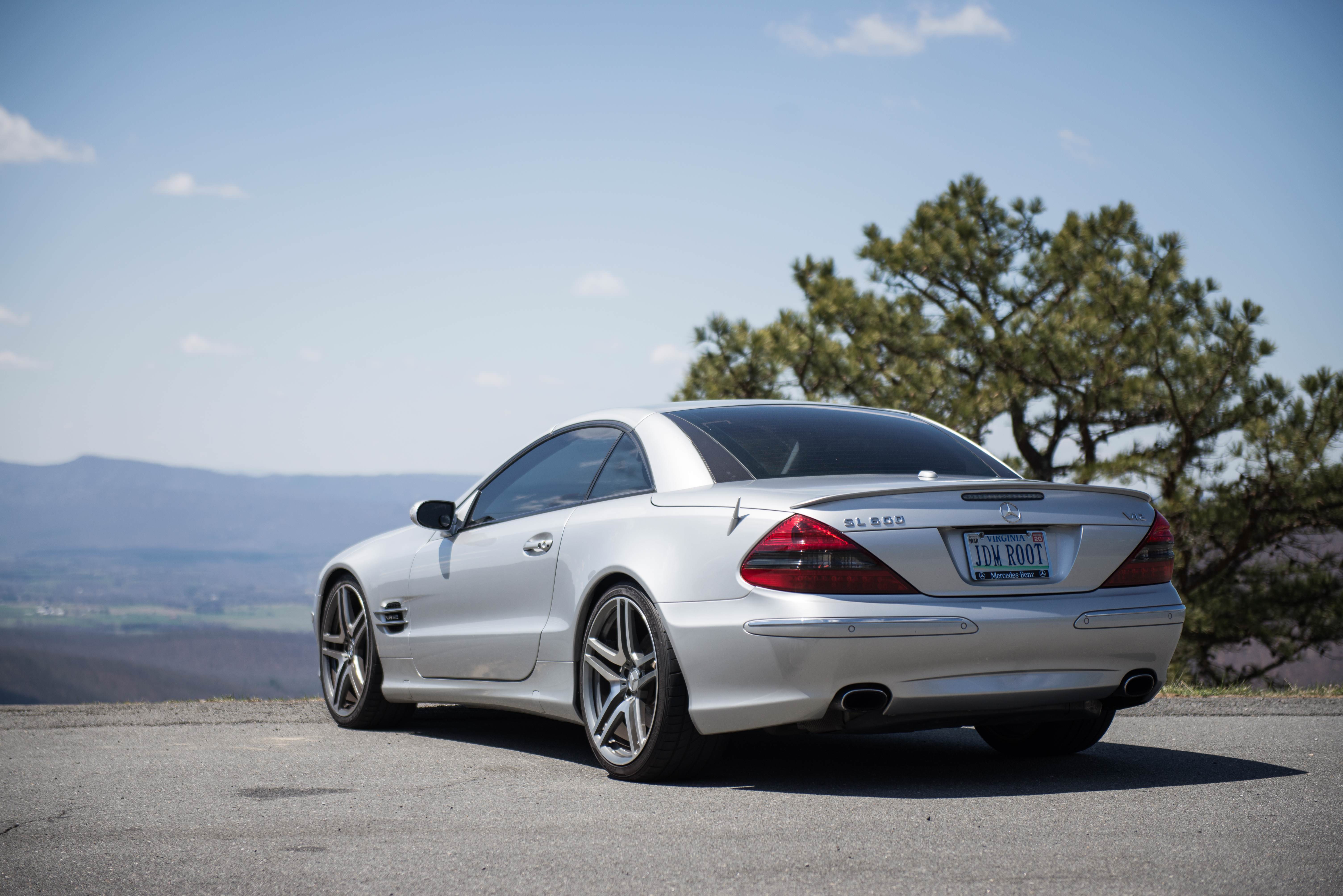

My 2005 SL600 all fixed up!
Bought this car with 3 bad ABC hoses, a cracked radiator, a split expansion tank, and rusty brakes and rotors at 4 corners. Replaced/fixed everything, she runs like new now, and looks like new. Nobody believed it was 13 years old, paint is immaculate. Taken it to the dealer would've cost at least $10K for everything...I did all the work myself.
Next up in mods, SL65 front bumper and SL63 rear bumper with diffuser, and a taller deck spoiler...then wrap in pearl white.

Thanks again for your assistance in finding the part numbers for me, couldn't have done it without the help! i've put 500 miles on her since the repair and so far so good. Drove it 200 miles today up and down the mountain, hit a few nasty bridge expansion joints, bone jarring but didn't get any ABC messages.

they are reps, 20x8.5 ET 35 front 20x10 ET 35 rear. Wish they were a little more aggressive, like +25 all around.

Weird, everyone outside of the USA cannot see my pics, i hosted it on flickr, i have pics in this thread. Let me try IMGUR
Does this work for you? pic attached

Yes, after i fixed the ABC hoses, and the radiator and expansion tank i took the car on a torture test. Had Waze up and basically drove the car like a Dbag all the way to shenandoah, then went the entire length of skyline drive, popped out on 340 then headed back to DC. Drove almost 300 miles total, didn't let the car rest except for a few pics. I wanted to see if the radiator will hold up to extreme heat, and it did. I bought a no name rad on ebay for $60 so i was expecting it to blow lol.
I wasn't aware the AMG sideskirts are different than what i have now? Looks the same.

They have a more aggressive looking lip on the bottom edge. And the lip is full across the entire horizontal length, instead of having an "offset" in the middle like yours.

After i get the AMG bumpers we can be twins heh. I like your wheels, what size are they? I'm thinking of going back to 19s, the 20s look good but ride a little rough, esp when i have it on the lowest suspension setting. I just got this car and is my first Benz, so still have lots to learn.
If the ride is rougher or bouncy on lowest setting, you are probably on the bump stops. Adjust your links a couple turns and it will be a lot better, but not look as slammed. I did this on mine...low, but not too low.

Yeah when i got the links, i only lowered it 1" all around, the picture you see is on its lowest setting. I usually have it on high, or medium around town but on smooth highway i'll have it on low.
