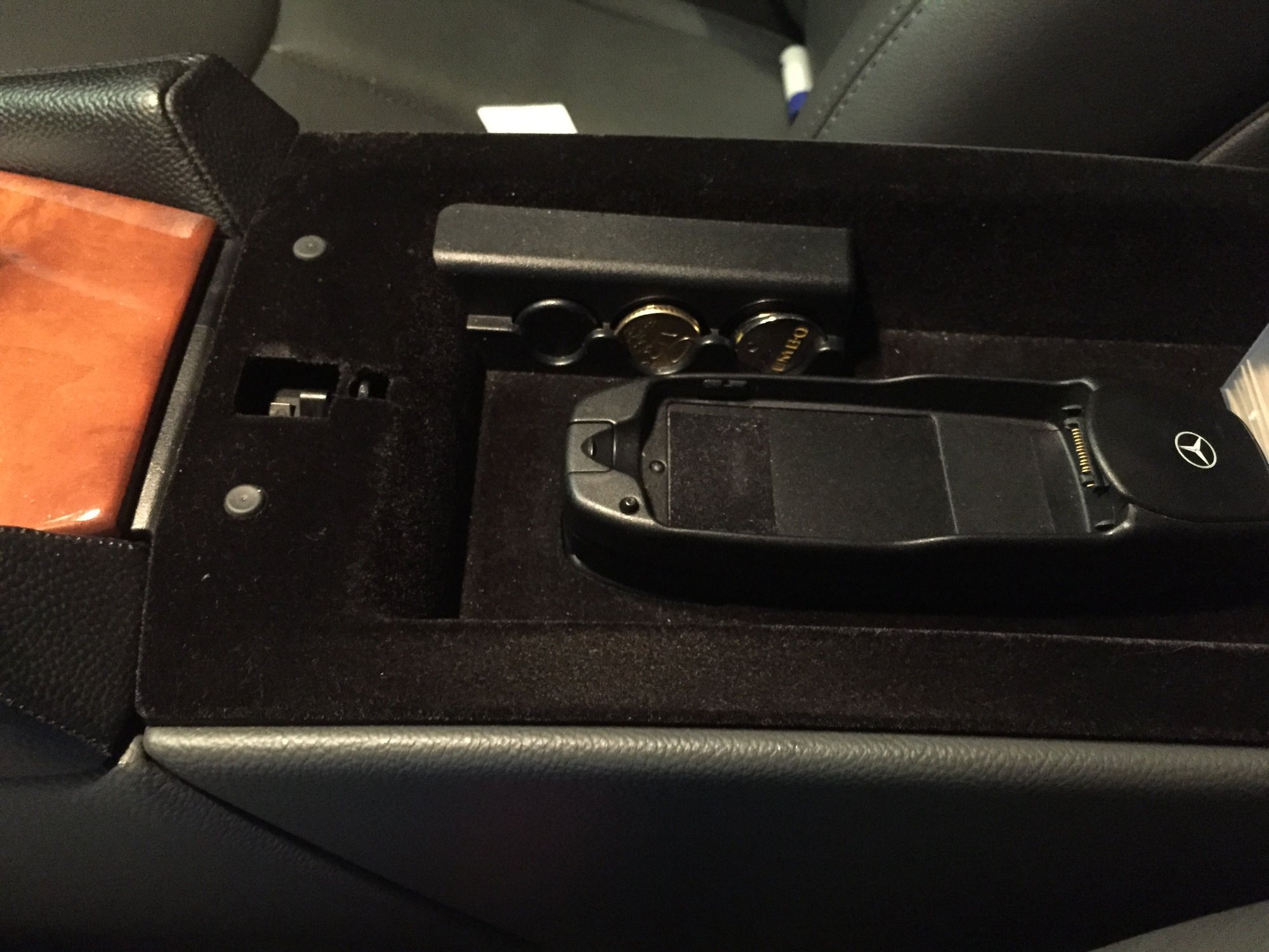

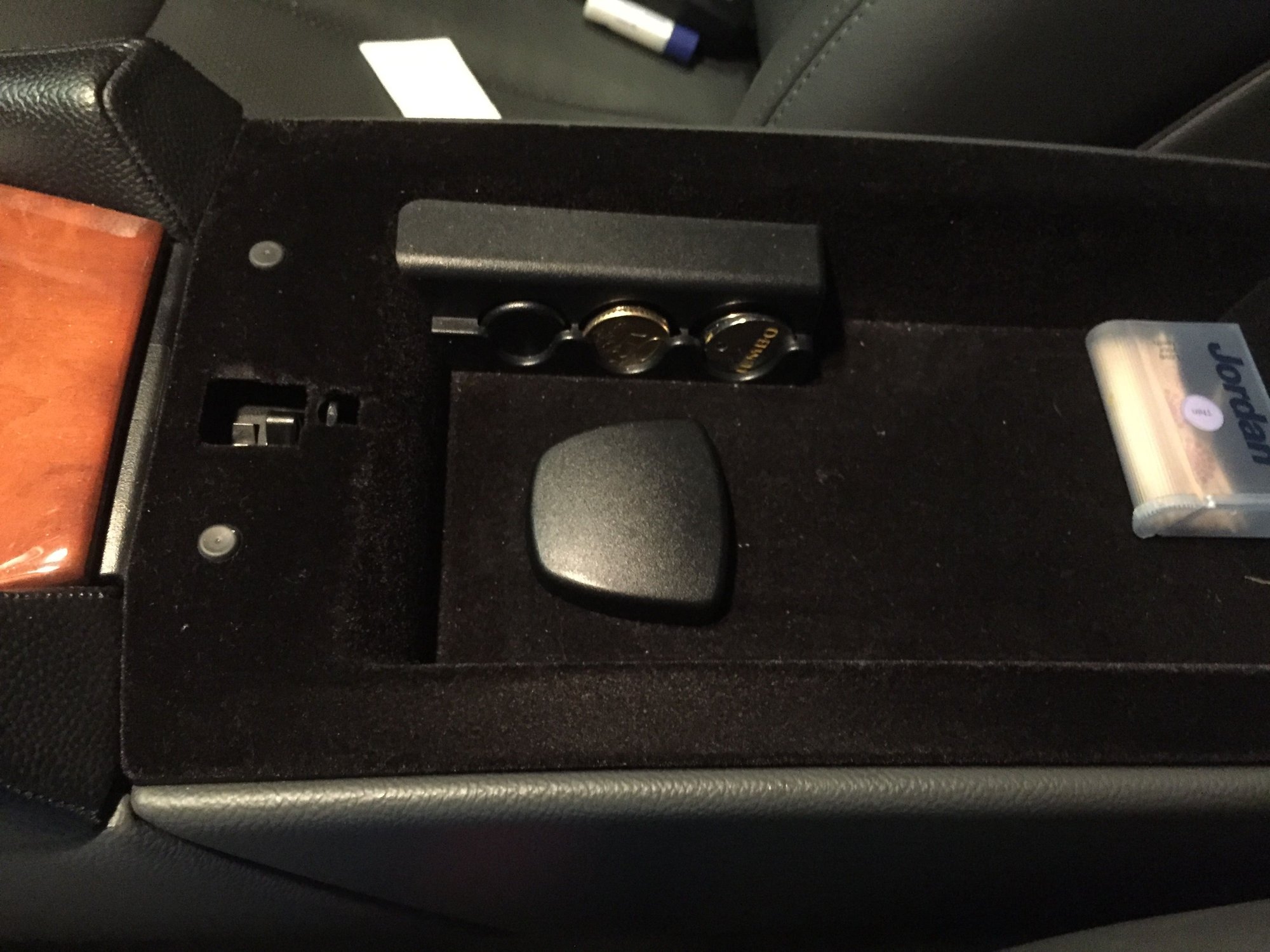

In upper central armrest. With cover.
Cover gone.
Nokia cradle clicks on (got it for next to nothing on eBay).
Had this Stone Age phone laying around. The battery incredibly still lasts forever with the car switched off. iPhone switches through to Nokia number while I’m driving. Pairing IPhones with Bluetooth pucks can be a hassle.
