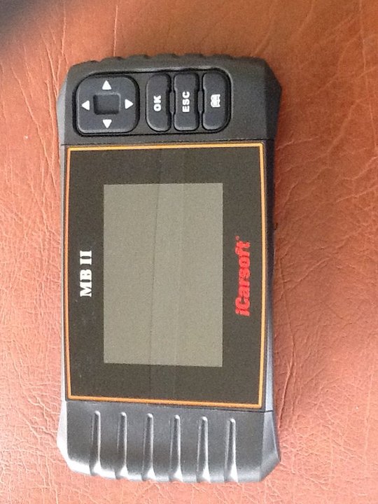

Both the AGS (shifter module) and the TCU have codes that can be read and give you an idea of what is wrong. If you are going to DIY repairs and maintenance on this car, you do really need to invest in a a scan tool. In fact, you really need SDS as you would use it for deactivating and reactivating SBC when working on the brakes. Also, it can actuate ABC ("rodeo mode") for doing a fluid change. But, at least get one of the iCarsot or Autel units I mentioned so you can read codes beyond the ECU.

This one states it will do what need.
