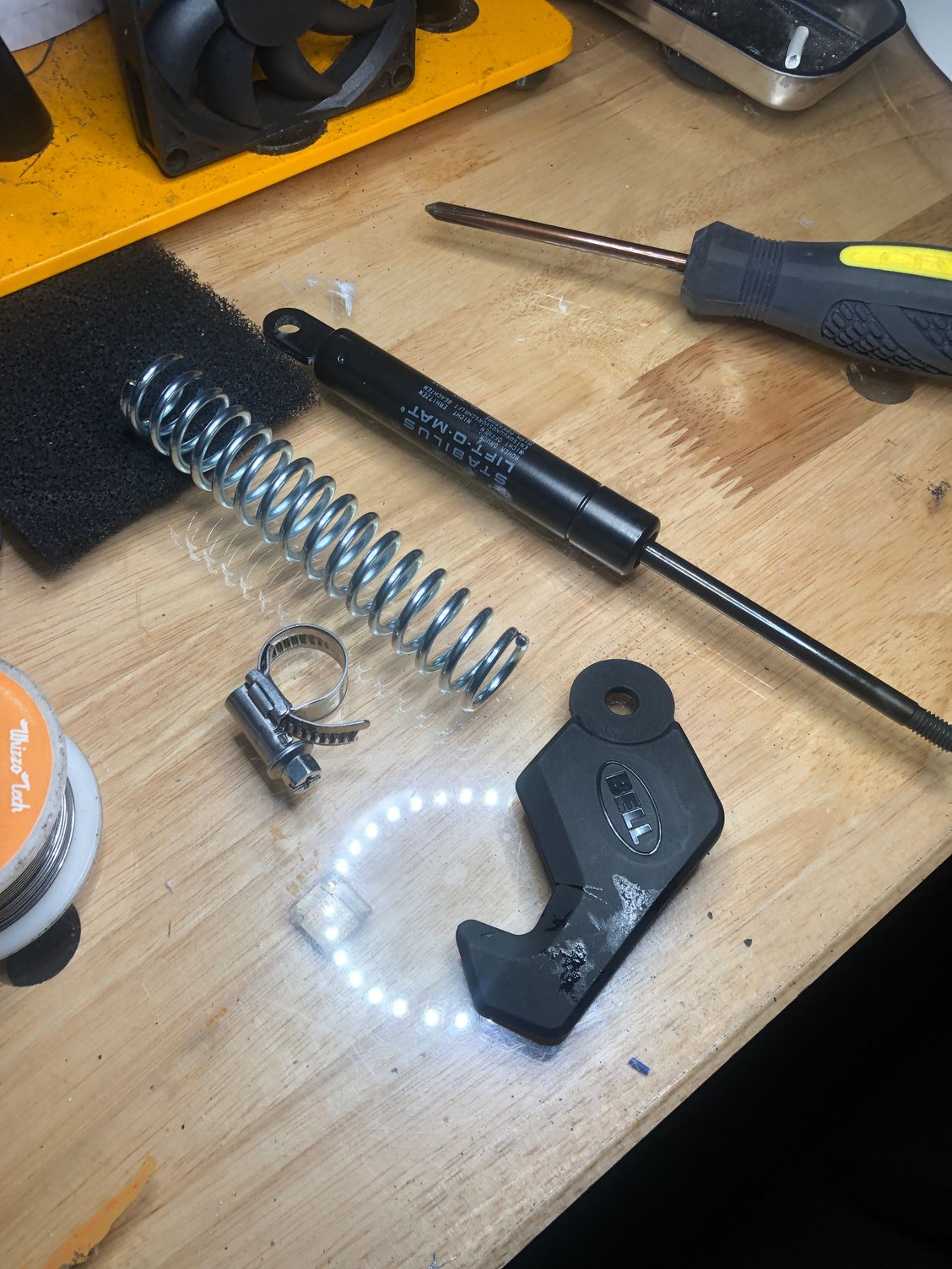

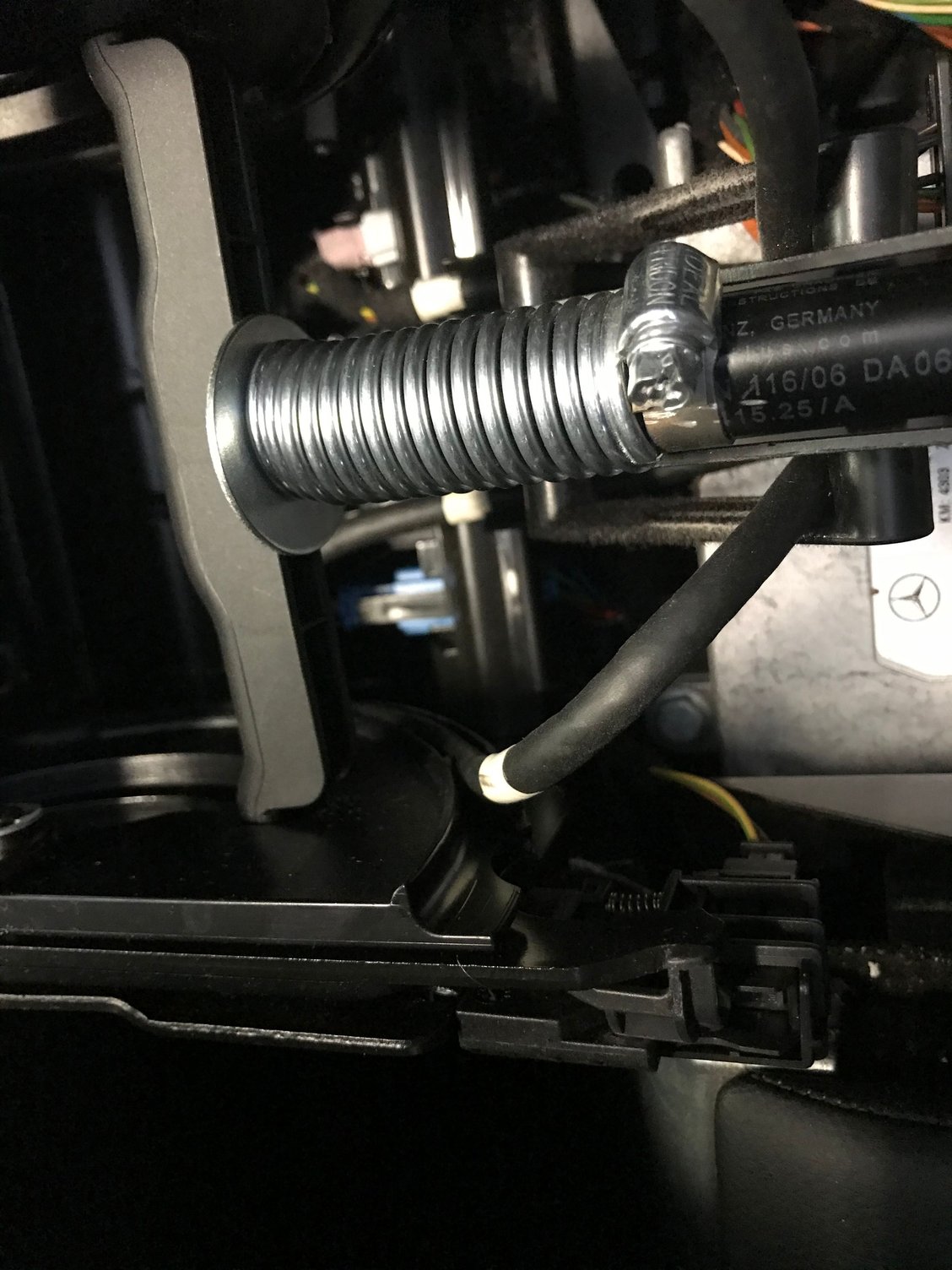

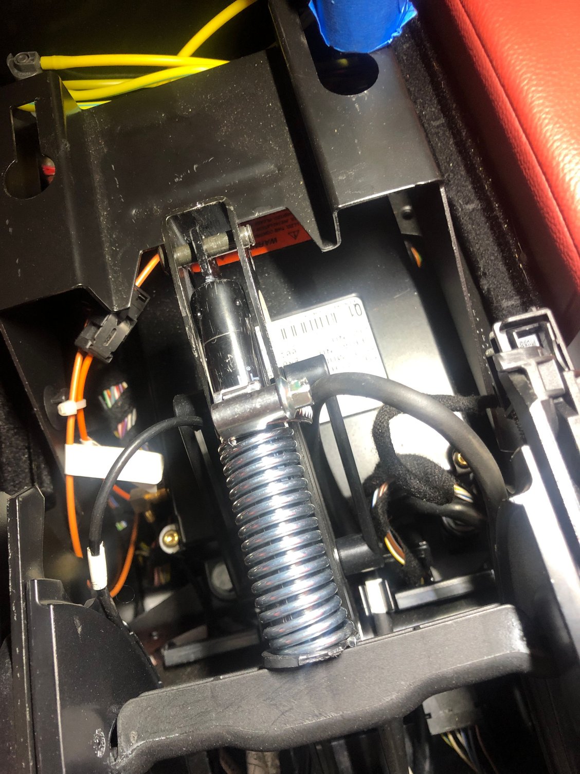

Not to resurrect an 18 month old thread (I’m sorry) but I fixed mine today for a grand total of $5.
Lowes sells screen door springs, to keep the wind from ripping the doors off the hinges. $4.48
I disposed of the chain and the spring itself JUST fits over the gas cylinder. I added a fender washer (25 cents) and a small hose clamp (already in my toolbox) and the results are attached.
And the beauty of this is by moving the clamp in or out you can adjust the spring tension.
Took me longer to find the hose clamp than to make the repair!
Link to Lowe’s piece
https://www.lowes.com/pd/WRIGHT-PROD...-Stop/50102496

The spring is a nice solution, and great that you can adjust the tension. I replaced mine a few months ago using the lift supports depot strut, now it works a little too well! The latch on mine is a little worn down, so if I bump the lid wrong it will pop open.

Second on the spring fix, works great. If I really had to nitpick, it “feels” like a gas strut but mine makes a very slight spring noise. I told my wife to listen to it and she thinks I’m crazy. It could be moving ever so slightly but if you open it normally you don’t hear it.

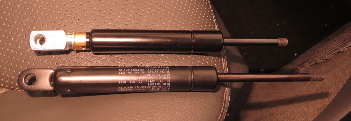

I think I have found a direct replacement for the OEM gas strut (no modification needed), and have just ordered one.
Cost was £20 (UK + posting)) and it has an adjustable gas tension between 20n and 400n.
According to my measurements it is an exact match for size....
Will report back when arrives and see if it works.

Well I have replaced my worn out gas strut for a new one.
This strut seems to be available from several sources, not just WDS in the UK, and quite cheap at about £12 ($20)
You also need an M6 with dia 6mm hole clevis. It needs to be as short as possible, but 24mm is about standard size.
It was almost direct replacement, I had to cut down the fork clevis that fitted to one end with a hacksaw and then cleaned it with a file.
I cut about 2mm too much off!
Then needed to release gas from the valve, so that it would move up and down easily, and stay up. Very easy to do.
Here are the results
Total time, including cutting the clevis fork, about 1 hour.

Originally Posted by Frederick NL
Aren't those not just screw on screw off parts? I just transferred it from the old to the new strut..?
Picture of original v new
I think the only significant difference is the original allows the box to open a little further (see my original pictures).
The clevis on the original is welded on.
