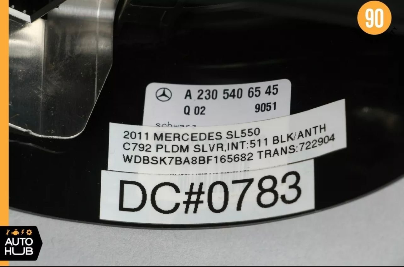

I just wanted to update the thread in case someone else has this problem. I ended up taking a risk and buying a whole steering column module assembly used off eBay. My concern was that I might need to have the steering column module programmed to work with my car since the one I bought came off another car. I figured for $100 it was worth the risk. Luckily the part on eBay also show the VIN from which the part came from so I did a search for the build sheet on vindecoderz and I made sure the SL it came from was a later model SL550 with the sport paddle and same transmission. Once I received the part I quickly swapped it out (actually pretty easy to do) and took 2 long drives and never had the problem of it randomly downshifting. No programming necessary.
